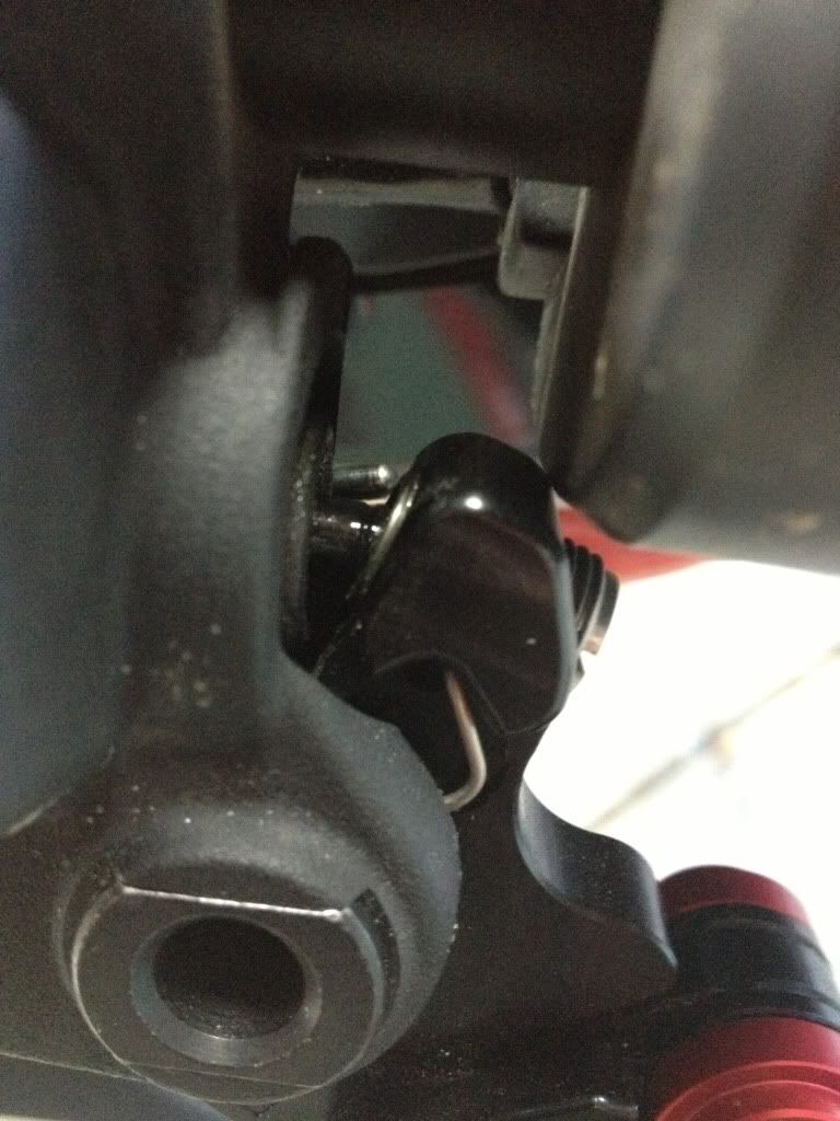

Ive had the bike for a little over a year, however Ive done all the services myself so I'm not sure if my warranty is still good. I dont have any free play at the lever that I can see. The adjustment screw is all the way out. Isnt that how I adjust the free play?
That's how you do it, but if it's that far out there should be some free play...
Plunger rod seated in the cup at the end of the adjuster screw?
gitter
As far as I can tell it is. Are there levers that dont offer enough free play? (I cant imagine this being the case due to the fact that pazzo is one of the larger manufacturers when it comes to levers)
gitter
Looks good, but that doesn't mean much.  You want 1-1.5mm. (.04-.06") at the lever.  I posted 2mm. before more as a trouble shooting guide.  Too much free play can cause clutch drag, making it hard to find neutral.
