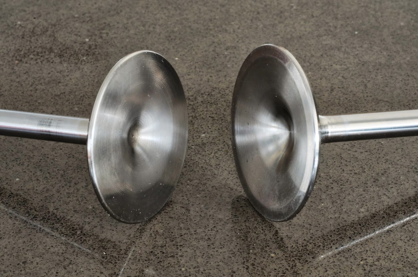

I bought a 696 valve to try (part no. 2101075B). They're different from 695 intake valves in three important respects.
Firstly, the diameter (44 vs 43) - like d'uh, this is the reason I was keen on them.
Secondly, the distance from the end of the stem to the collet groove is much shorter on the 696 valve. A picture shows the difference well. The 695 valve is on the left, and the 696 valve is on the right.
Distance from tip to the tip side of the groove is 16.3 for the 695 valve, vs 10.4 for the 696 valve. So a show stopper.
The third reason makes me not want the valve even if I could get it to fit. The tulip shape is considerably different. Again, a picture, with 695 valve pn the left and 696 valve on the right:
The recess in the 696 valve is much more pronounced than the 695 valve. If you look at the back of the valve (first pic) you can see the back of the valve is taller on the 696 valve. This probably improves gas flow, but it would make the valve more likely to clobber the valve guide, and the big hole in the front of the valve would also decrease compression if used with a 695 piston.
Oh well, it was a nice idea, but wasn't to be.
