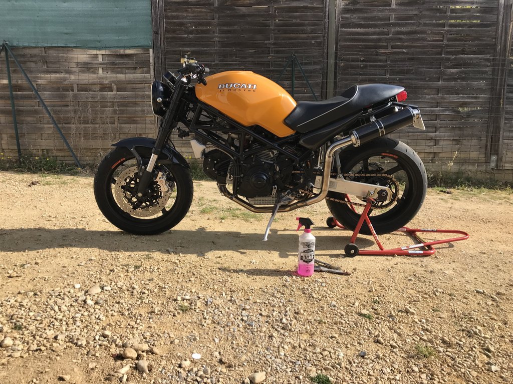

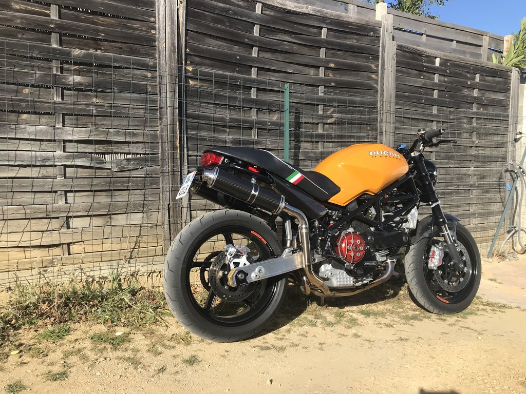

Good annual wash  ;D
Here it is clean  [drink]
So this afternoon I went dirty by my house, it's worth two turns of the Parisian ring road no more.......
Road Book
And then the souvenir photo   [beer]
