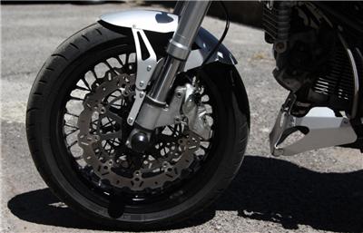

Pistons...Would have liked to give a sponsor the biz but they're insanely cheap (JE for 900, $250/std or big bore!!) on eBay. Sorry but that's $70, and I need to buy useless crap like this with the savings...a DP alloy "spoiler"? to match my DP alloy fender  ;D
