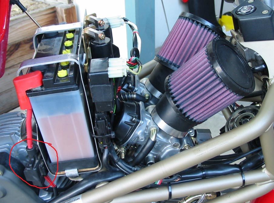

I never touched tail spring and clicking-screw.
Sometimes when I ride with passenger(depends on her weight) I feel that bike is more stable and ride is more comfortable. It has something to do with suspension.
What should I do? Tighten up spring or lose it? Or just adjust clicking-screw? [shot]
