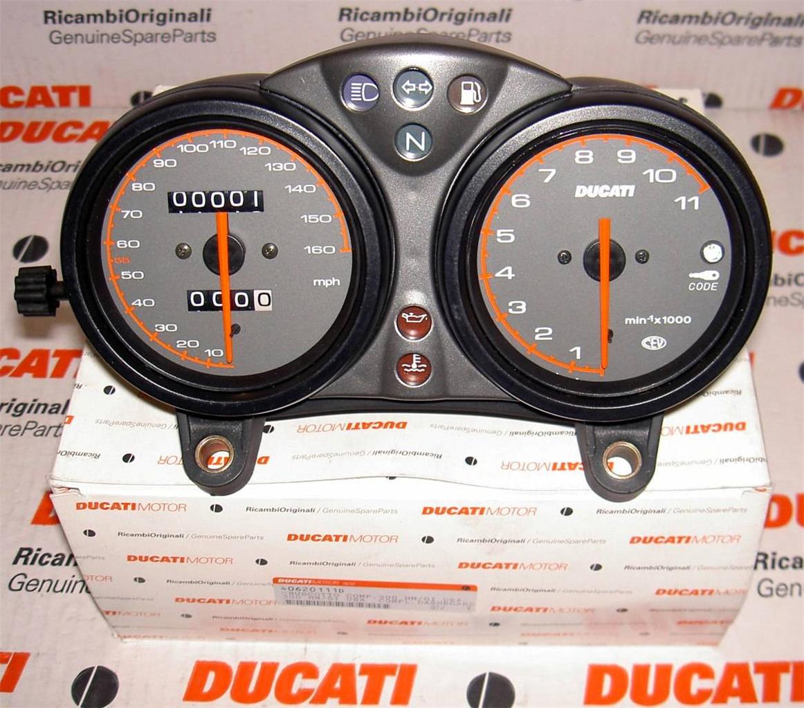

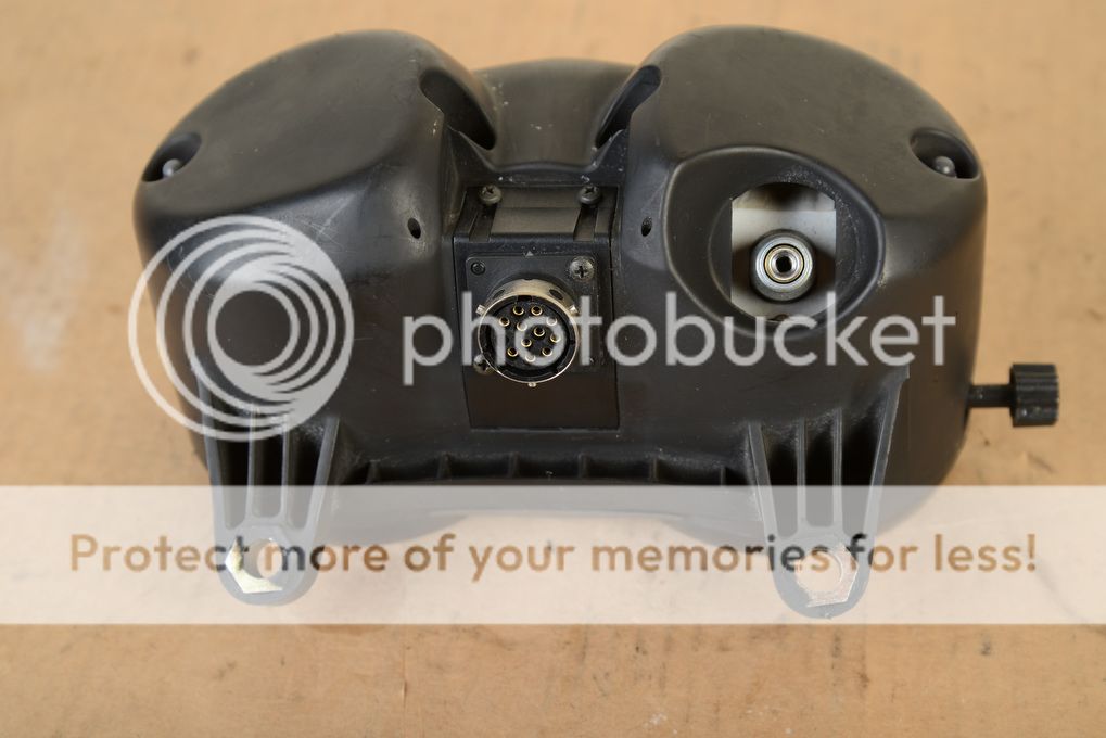

I'd like to see pics of the front and back of this 2001 M900 gauge cluster.
Cable drive speedo and tacho is what you're saying, yes?
Rudemouthsky
Quote from: Speeddog on May 02, 2014, 09:29:46 AM
Yep, or so I thought;
Front:
Back:
The part numbers that are identical between the '01 M750 and '01 M900 are the following: speedometer, wiring pigtail. Basically the tach is the only thing whose numbers don't jive. The backside looks identical to my M750 dash, here's a photo for reference of the M750 backside:
