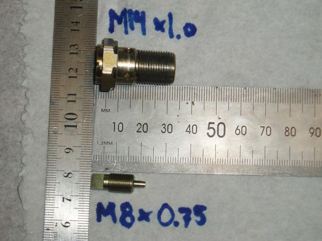

MonsterHPD
#9
Is this the broken part (i.e., the compression adjuster)?
  http://i855.photobucket.com/albums/ab117/Monsterhpd/Monster%20Forum/ShowaKompjusterare_zps1dec2ec9.jpg
Shit Photobucket, can't copy the picture url, but I think (hope ...) you'll see the picture if you click the link. Anyone can recommend a better place than Photobucket for free picture storage?

brad black
if it is at the bottom it's a compression adjuster.
it's not shown as a separate part by ducati.  it appears the early 90s gsxr forks have the same valve, try a suzuki parts list.
like on these ones: http://www.ebay.com/itm/93-94-95-Suzuki-GSX-R750-Front-Forks-Axle-GSXR-750-/331214532287?pt=Motorcycles_Parts_Accessories&hash=item4d1decaebf&vxp=mtr

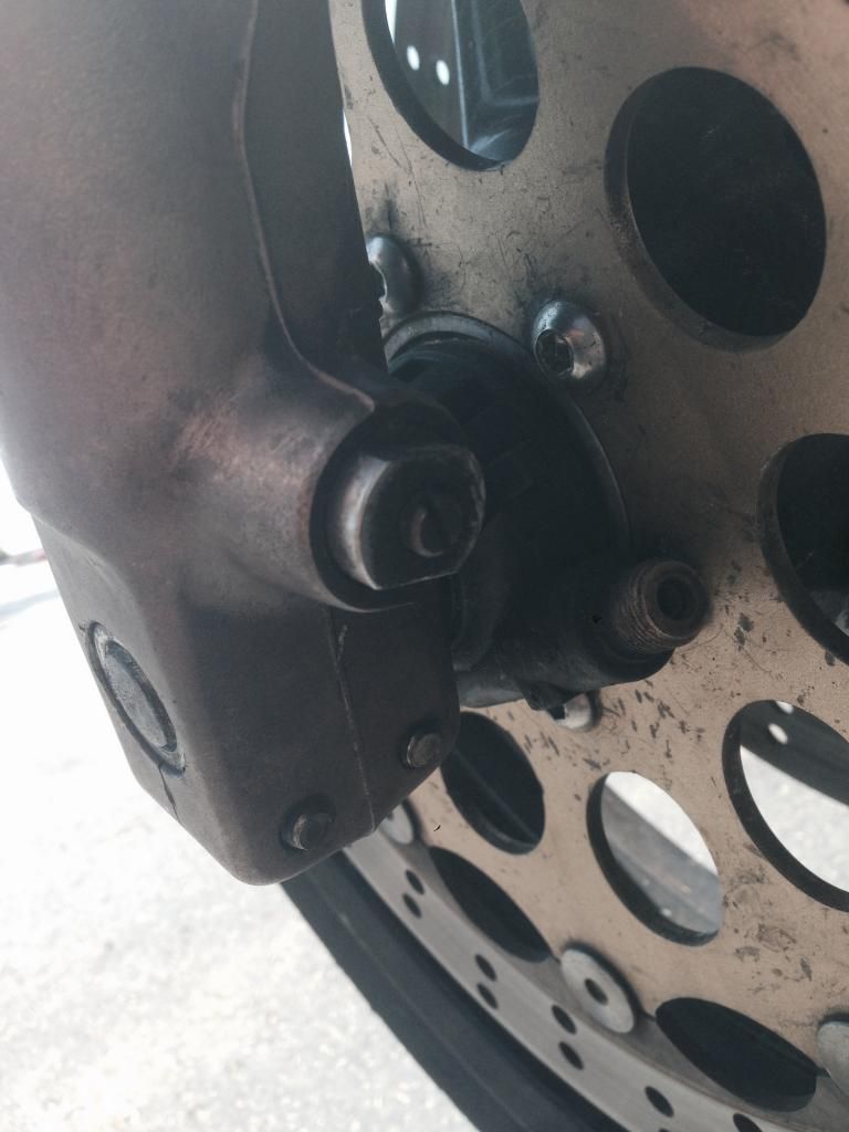

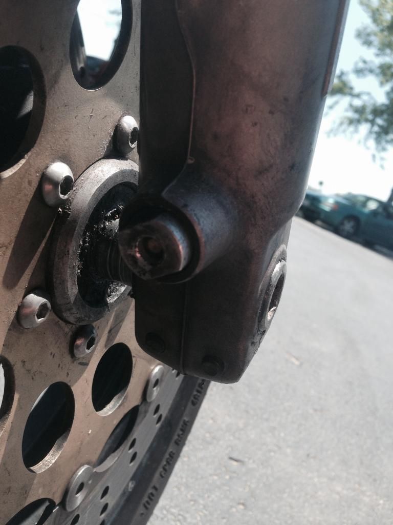

ChrisK
Here's the side with the broken screw head:
And here's what the good side looks like:
