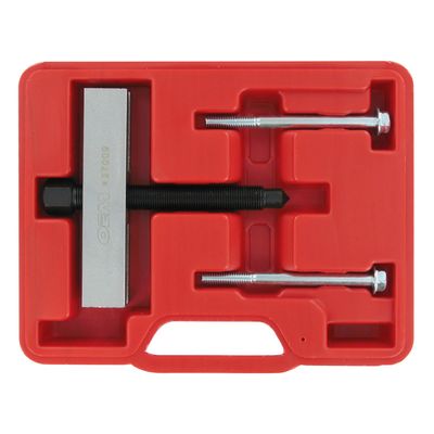

Quote from: bond0087 on May 28, 2012, 02:33:10 PM
How to pull your alternator cover for free or for under a few dollars:
If you are going to take off your alternator cover (or stator cover, whatever you want to call it) , you need a tool to pull the cover off of the engine. If you were to pry along the edges, it would probably never seal again. There is a special tool from Ducati for removing the cover, or you could buy an aftermarket version for roughly $25-$40 I think. Alternatively, you could use a regular puller, for example a timing gear puller.
Autozone stocks a timing gear puller for $15, part brand/number OEM 27009. The great thing about this tool is that it is one of Autozone's loan-a-tools, so you can borrow it for free. After that, you just need to get a pair of M6 (I think.. it could be M5, I would check first) bolts that thread into the alternator cover where the inspection cover comes off. You'll probably need some washers also, unless you can find a pair of M6 flange head bolts easily. You really don't need to even buy those, though, because if you're taking the cover off, you probably already have a wealth of removed fasteners that will work sitting around. Just take those and some washers, use your rented puller, and return it to Autozone afterwards for a full refund of your deposit.
Just to be clear, the bolts go through the slots on either side of the tool, with washers in between the bolt head and the tool, because the slot may be wider than the bolt head. The bolts are then threaded into the inspection cover holes, and then the middle part is turned until it makes contact with the shaft, then turned some more in order to pull the cover off. If it is difficult to pull the cover, you've missed a bolt (or have a much lower definition of difficult than I do). I say this because I started turning it and it was difficult, and then I realized that I missed a bolt on the cover, behind the sprocket cover.
If you're like me, I know what you're thinking when you see that tool: "Well that looks fine for the most part, but is that sharp tip going to ruin something when I start pulling with it?" The answer is no; there is nothing for the tip to poke, so instead, the contact area is a ring right around the conical section, and the load is distributed evenly along the inner diameter of the shaft (at least on my M750 engine, I'd be surprised if it was different on other engines, but I would also double check if I were you).
Of course, there are other manufacturers of the same type of tool (Performance Tool W87010, for example), and probably other stores that will gladly rent you one, but for those in the US, I think Autozone will be the easiest.
Disclaimer: I didn't actually use this exact one, nor did I rent it from Autozone. I am 99.99% sure that this will work, though. I had a seemingly identical tool sitting around from something else, so I used that, and then I saw that this one was available for rent at Autozone when I was looking for something else.
Worked for me (00 M750) 2 M6x1 bolts about 1 1/2 inches long and couple washers good to go.
