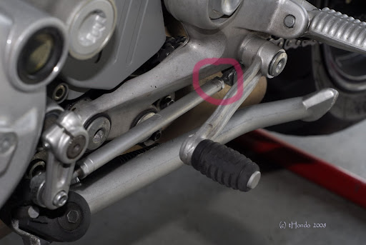

Quote from: NAKID on August 08, 2008, 03:17:40 PM
You have enough room. I did it on my S2R...
Nope. On an 05 S2R sold in the US it can't be done. I've tried switching the connecting rod from side-to-side to gain clearance (can't) and every rotation angle of the shifter flange.

Quote from: tangueroHondo on August 08, 2008, 06:57:32 PM
Dude, my first Duc was a U.S. model 05 S2R Dark. I had it reversed for about 3000 miles before I was hit by a semi...
Edit: Found a pic
Now obviously it's a little bent from the collision, but it is TOTALLY doable...

tangueroHondo
Posts: 196
Re: Reverse "GP" Shifting
Reply #68 on:
August 09, 2008, 01:55:15 PM »
Maybe something on my unit is bent? I thought maybe you guys were attaching the connecter rod on the OUTSIDE of the pivots in order to score room, but from the pics, everyone is leaving it on the inside. I'm just gonna buy a Gp shifter and call it a day. i'm sick of all that linkage and shit anyway. It looks like a cluster fuk.

August 09, 2008, 02:26:49 PM »
Quote from: tangueroHondo on August 08, 2008, 01:48:05 PM
I've got a prob - 05 S2R - Not enough room. When I rotate the shifter flange the connecting rod can't get the clearance it would need to reach it.
See the nuts at either end of the shaft? Loosen them, then turn the flanges to make the linkage longer. You should get more clearance that way.

I got a problem. I tried this on my '94 m900, and it works when you move the shifter up, but when you push down, the linkage hits the shift lever pivot. I can't see how I'll adjust anything to fix it. The only way is to change the angle of the shifter, but it's right where I like it now. I don't want to bend the linkage.
Anyone have a pic or any ideas?
desmoquattro
Posts: 4088
Reply #74 on:
August 27, 2008, 08:08:14 PM »
Quote from: Howley on August 27, 2008, 08:03:32 PM
I had the same issue with the Supersport. I basically had to lengthen the linkage. Take a look at the ends of the linkage: there are two nuts on each end that positions the eyelet. You can loosen those and turn them to lengthen or shorten the linkage.
If you can find a position for the shifter arm that actuates the shifter splines cleanly both ways, you should be able to shorten or lengthen the linkage to accommodate.
