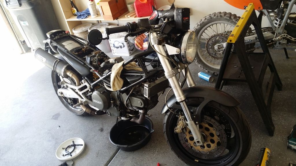

Here she is next to my 2003 KTM 625 SXC.

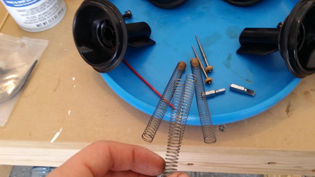

She was cranking and cranking, but would not start, so I started tearing her down.

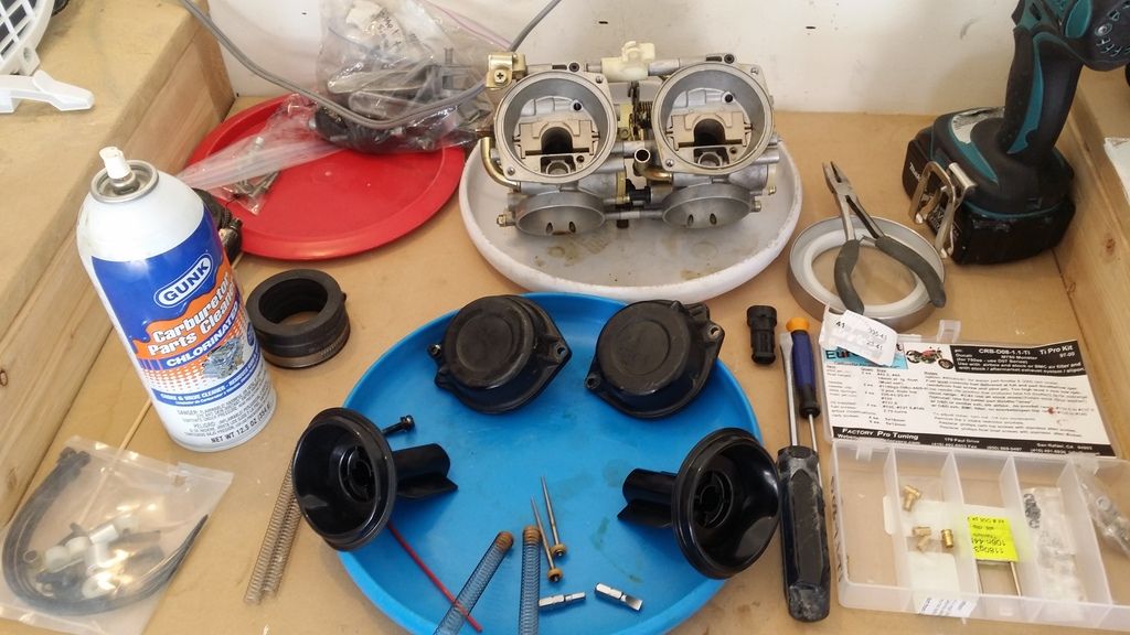

The guy I bought it from bought a carb rebuilt kit. He replaced most of the components.
I put new springs in it, and titanium needles.
Put her all back together and still won't start D:
I was getting backfires and flames shooting out of the right exhaust.
Did a quick search on this forum and BAM!
Someone had the same problem, and they had the spark plug cables switched.
I pulled them off, switched them around and BOOYAKASHA!!!!

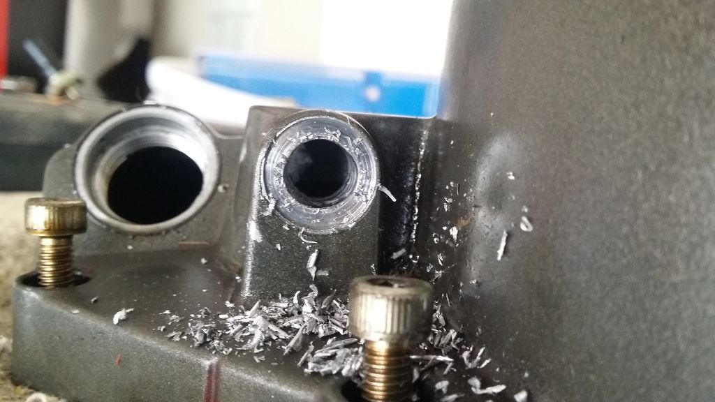

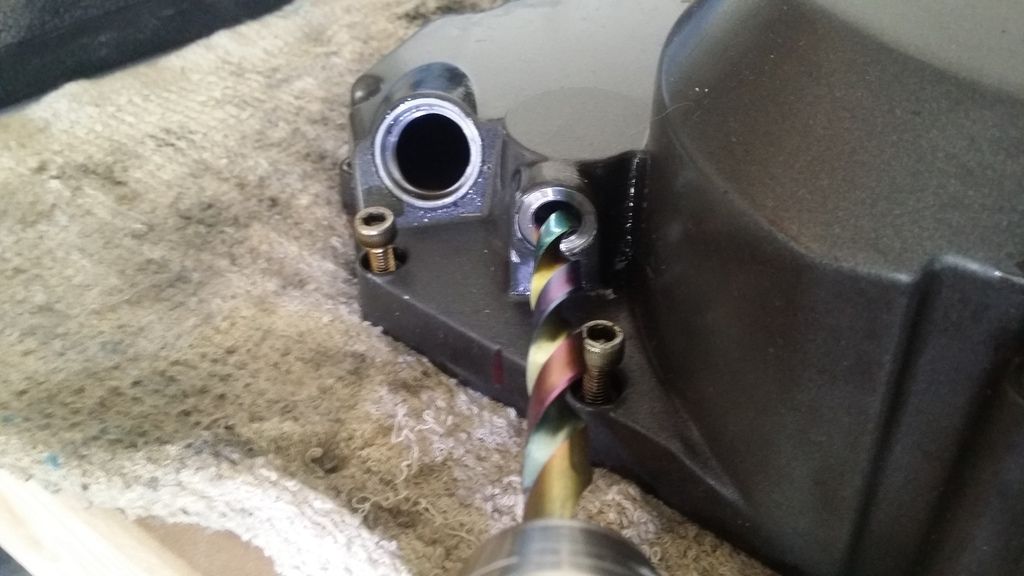

The oil pressure sensor was cross-threaded and had all of the threads on the cover stripped out.
I ordered a M10 x 1.0 Helicoil kit from Amazon along with a 13/32" drill bit.
It's going to be here on Wednesday, so I'll post some pictures when I do that.. Never done it before. pretty excited. haha.

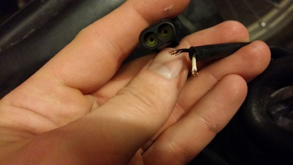

Bad news. This is the fuel level sensor. I haven't really looked into repairing this yet.
Anyone have any input on the way to do this?
I'm not terribly concerned about it, because it starts without it, but after I get the major issues fixed, I want to restore this to as near perfect condition as I can.

Grease the tap for the helicoil to keep shavings from entering the oil passages. Crank the motor after to flush any that do get in.
Fuel level sensors are a known problem on Ducs. They're expensive. Most just use the odometer to gauge when to fill up.

My plan was to remove the entire cover. That would eliminate the possibility of shavings getting into the engine, as I imagine that is a key area of oil movement.

I was thinking about buying a generic electric connector and cutting the OEM and soddering it in to get the fuel indicator sensor working.
Would that work?
Most likely the wires are cut because the light was on all the time.
You still need to make sure you get all the shavings out of that passageway cover on or off.

Speedo is mechanical.  Your connector fix will be fine, but as duckpainter said, the sensor may not be.  Either way, always go by the trip meter.  The wiring diagram for an '01 750 found here http://www.ducati.com/services/maintenance/index.do  at the back of the owner's manual should help.  Pretty close, notable differences being no safety relay or tach on your bike.  Get yourself a cheap digital multimeter.  Let us know what you are getting going into the fuse box, get the heliCoil in and let us know if the bike starts.

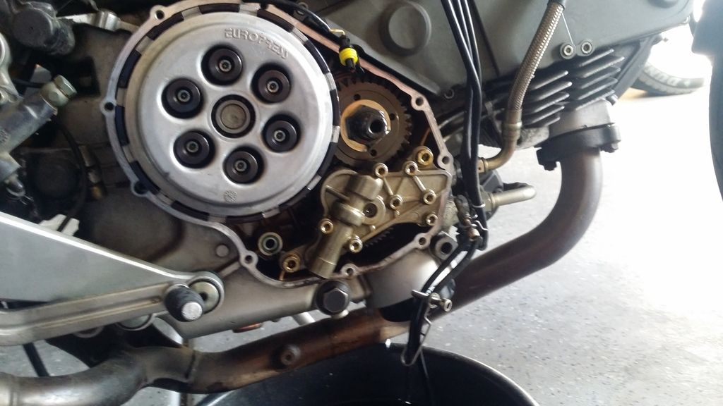

So, I got the Helicoil kit in the mail today and got to work right when I got home.

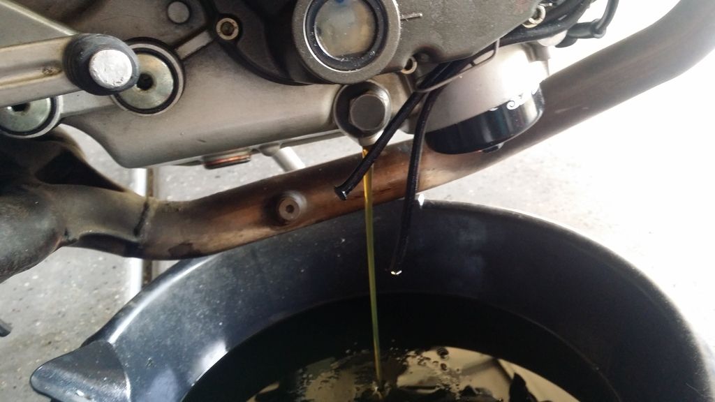

First, drained the oil.
You can see the threads were wasted inside there
I carefully drilled it out with a 13/32" drill bit

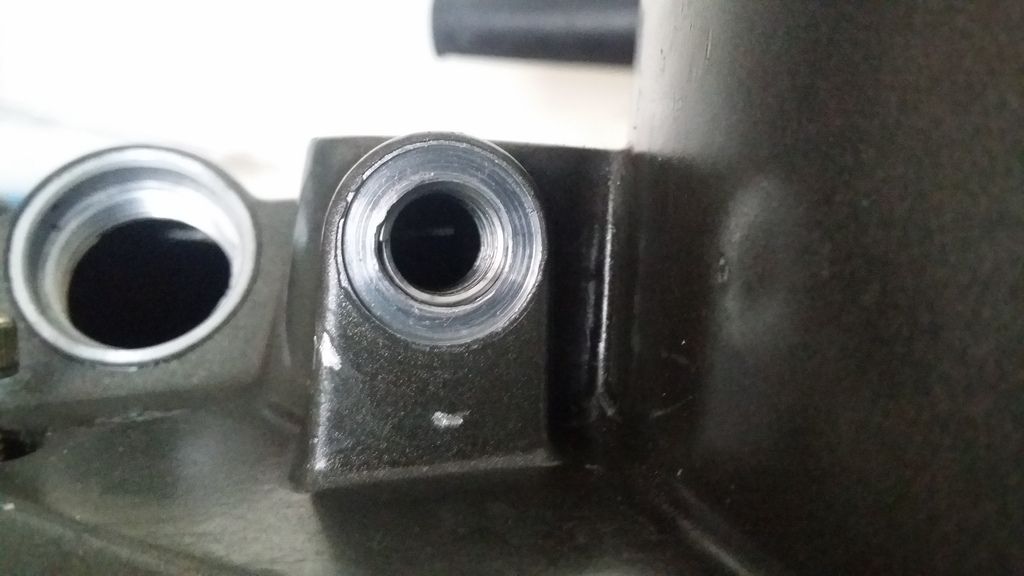

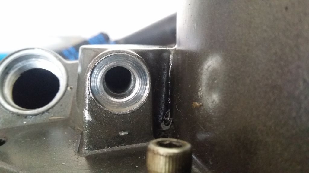

Not bad

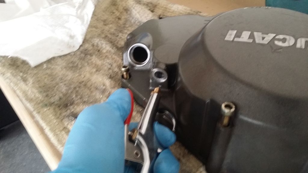

Most important part is getting all of the debris out. I blew it out after every step
You can't see it, but I threw some locktite in there. It turned out pretty nice.

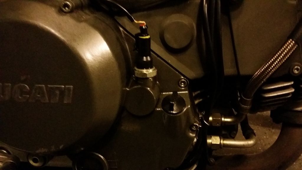

When I pulled into the garage, I looked down and saw oil leaking from right here.
What the hell is going on?
Is the sensor busted? It's leaking from the top of the sensor.
I'm thinking about just throwing a bolt in there to ride around with. Is that sensor a vital piece in the operation of the engine?

Yes, you need to replace the sensor.  Oh my, the drain plug is the big one with the copper washer, not the one you removed.  The fastener above the plug you removed ain't right.  It is supposed to be a 14mm. allen, and under it another 14mm. allen with a screen attached to it.

His oil screen could be a hex head. The one on my '96 900 is a 21mm and one piece.

Yep, old 900s were one piece screen.  I might be wrong, but I'm pretty sure post Pantah 600 and 750s had seperate cap and screen.  IMO, worth taking a look.

The oil pressure switch can leak from the top if it's had a knock.

I knew that was the wrong oil drain plug, but I wasn't doing a full oil change, only emptying her, filtering the oil, and putting it back in.
It worked for my purposes.
