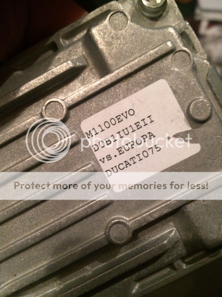

I've picked up crashed 2013 M1100 & the dash is smashed! The bike came without keys so I have no idea how many kilometre are on the bike! Do I need a new dash to see the kilometres or is it possible to some how get the ECU read?

Cheers, how can I get the ECU read? (For reference photo attracted of ECU  :))
via dds1.0/2.0 maybe Socio scantool[expensive] oem level tools

Will most Ducati dealer have that equipment? If not do you know anyone that offers a ECU reading service?
Cheers again
Quote from: MonsterMadMarty on September 16, 2015, 11:01:35 PM
Cheers again
Yes, most dealers should have ALL from Mathessis to DDS2.0
