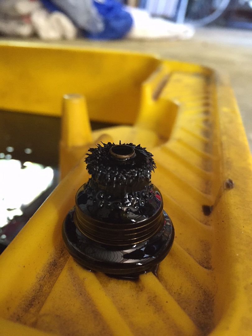

Massive engine issue! A mate was riding his 748SPS & was sat at the lights idling away, when suddenly he heard this God awful noise coming from the engine! He tells me he rode off but after two minutes shut the engine down & called me to come rescue him.
After dropping the oil the sump plug looked like this:

Lots of swarf on that drainplug magnet, definitely not a good omen.

I'm still not convinced the amount of swarf found on the sump plug would be a single mashed ball bearing but my next step is to give the bike a short run on Sunday, drop the oil check the sump plug & filter then go from there!

Id put in some cheap oil and run it for 5 mins then change the oil and filter. Check the sump plug and decide if you want to run the bike for and extended period.
