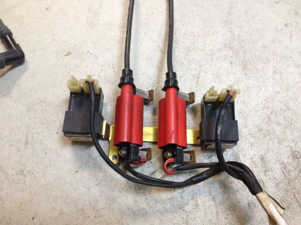

1998 IGNITER BOX WIRING?
Try as I may, I cannot find a 98 diagram for this bike, and have been muddling my way through with a 96 diagram. Just got a Factory manual 'donated' but unfortunately it is a 91 book  :(
I know we've had a bit of a chat about the igniter box wiring, but it seems every book I have is different to what I have on the bike. Does anyone have a 98 900SS that they can verify the colour coding?
Here's what I have - looking from back of bike
RH Coil = Vertical cylinder - Grey/ Red on coil
RH Ign Box - Reading from L to R,  2 pin plug = Black/Yellow. 3 pin = Black/Grey/Red
LH Coil = Horizontal cylinder - Green&Brown/Red on coil
LH Ign Box - Reading from L to R,  2 pin plug = White/Red. 3 pin = Black/Green&Brown/Red
Seems both books I have show the LH 3 pin having the Black/Red 'flip flopped', but both books with Green&Brown in the middle. Someone could be playing tricks with this - so, can anyone please confirm? I know the Black is a ground, so - what would happen if these wires are in fact reversed?

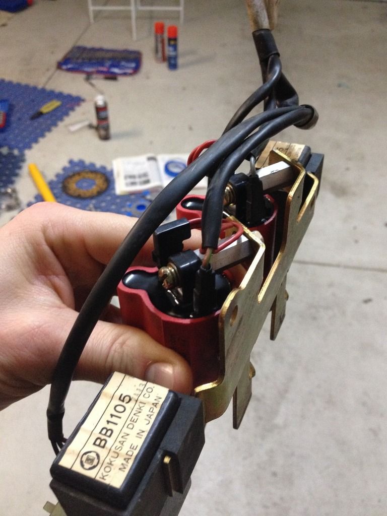

Tony - that's not what I was wanting to hear -although the "Helping you over a beer" sounds like a winner  [drink] [drink] None of the diagrams I've seen show any colours on the pick up wires to their plugs, however -the 96 Haynes book I have does at least mention colours, at least for which cylinder is which, - but not the wires in plug orientation. Both books I have show the power wire to the boxes/coils as Brown, and this one is Red. OK - that's not too difficult to figure out. It depends on which direction you look at the 3 pin plug wiring in the books, as they don't have any 3d orientation. A picture of one (even if the power wire is Brown!!) actually on a running bike would put my mind at ease! Whilst waiting for the new Rec/Reg arriving (tomorrow) I have been (again!) checking all the ignition wiring, and came up with yet another anomaly? Where all the coil/box wiring 'necks' down, into the 2 wire plug (on RHS of airbox) it makes sense that one is a power wire (from Stop/run switch) and the other a ground. So - why, with the Ignition switch OFF, and Stop/run switch on Run, do both the pins on the switch side of the plug read continuity to ground? With the Ign switch on, the power wire reads about 11.5 VDC - when battery is over 12VDC. Seems I often fight 'lecktrickery' gremlins - especially on older Jap bikes, but the Italians are generally a bit easier to sort out  :o
I've asked a mate with a 750 and stock boxes to send me some pics. The 900 I'm working on is Ignitech equipped and all apart.
2013 M1100 Evo
Brid
Quote from: koko64 on July 13, 2016, 08:26:01 PM
Thanks mate - next round is on me  [wine]
2013 M1100 Evo
A buddy up the road sent me these. It's all I got.
2013 M1100 Evo
Brid
That's good Tony - looks like both the Blacks are on the LHS of the plugs, so that answers that -- I'm good there. Got the new Rec/reg installed, but still no difference. Just so happens, the owner came up with another pair of stock igniter boxes (off a running bike) AND, another pair of the very same FCR's - brand new in the box (They ordered 2 sets at the same time, and these (on bike) were the only set used) So - I'm just putting the new ones on -- more news later!
