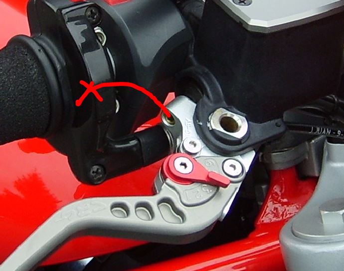

I was hit by an SUV while riding the Tangerine Dream in 2022 (coming from my mother's funeral, if you can believe it).  I got very lucky.  The bike... kinda lucky.  The frame sliders and handlebar sliders saved her.  My armor and training saved me. Walked away with a puncture wound from my jeans rivet on my hip and soft tissue damage on my shoulder- my head never hit the ground because I rolled out of it.  There is damage, and they wanted $3K to fix it at the shop.  My car is going to cost $2500 to fix and I don't have either amount.  I think I can get the Dream back up to semi semi-safe level.  I need to because if I do find a job, it could be in the burbs, and I have no transportation now. Here is the bare minimum I know needs to happen:
- Needs oil change and filter change (This, I can do easily and have the tools. I saw the tutorial and it looks simple).
- Needs a new front brake lever.  I changed the fuel pump, surely I have the skills to do this myself?  Do I need to do something special because of the brake cable?  Or does it just come out and I put a new one in?
- NEEDS NEW FRONT AND REAR TIRES.  These were on their last legs before the accident and I patched them twice.  I don't have the tools or know-how to remove and replace these.
There is other damage but I need a commuter and I think this is the bare minium that will get me up and running again.
If anyone has a CRG RC2 Brake Lever (2AB-511B-T-B) that they want to sell me for cheap in black, I might be interested.
Also, should I be worried about this gap that I circled? I know it was like that before the accident.
I feel blessed because she has sat for almost three years and the battery still works once I charged it so that is one thing that I don't need to worry about.
Super small wins.  That's all I have.  But this bike is the only thing that has been faithful to me and gotten me through hard times.  I'm hoping she can help me one more time.  I have such an emotional attachment to her because she's the only thing that's been there for me when I really needed some (one?  thing?).

Welcome back  [Dolph]  Sorry about your mother  :'(  You'll land another job, don't you think so? Of course, also happy that the crash didn't do more damage.
Tires, yes, they need to be working well.
Oil change, yes, you can do it. Visit a work shop after, to make sure it's all good.
Lube the chain, check/have checked that belts are at least ok'ish.
After the brake lever replacement, you MUST visit a work shop to have your work checked. Not optional.
Remove large flat nut under the brake master pump. Push up large brass screw. Remove lever. Make a note on how the micro switch is mounted (it controls the brake light)(small flat plastic thingy with two wires) New lever, brass screw down. Large nut screwed back in place. Easy. It's the safety check afterwards that you can't do youself.
Good  luck. Report back  [thumbsup]

Unfortunately, I literally have no income at the moment so no shop checks.  I can't afford it.
Do you know what size tool is needed for the brake lever?
You can see what sheared off the old one when I got hit.
"Do something each day that scares you..."
The brake lever pivot bolt is removed (and fastened) with an 18mm wrench or an adjustable spanner. Easy to take off and not much force required to put back
The adjuster I have pointed to is turned with an allen key. Maybe it's not required to adjust it, but you don't know that. So you need help. It takes seven seconds to verify and maybe 22 more to adjust. If you made a mistake or let's say the brakes need bleeding, that's another 15 minutes or so. N.Y. is a big place - there must be a few helping hands somewhere. Doesn't have to be Ducati people.
