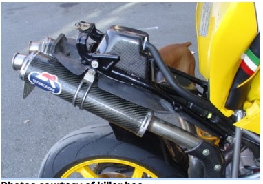

"Corsa box" on race set up superbike
Where do you have the space for this huge box on Monster's tail section?
Stock separator box on 05 S4R : really small, compare to the size of the box in the photo above
