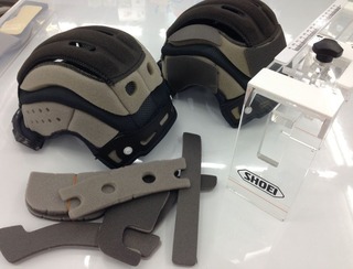

This is how "SHOEI's personal fitting service" is done. (Sadly, this service is only available in Japan, and some euro countries. Not yet available in US.)
Take the measurement of your head, front to back, side to side, and circumference
Add some form, to where you need,
Can you see where the extra foam is added?
You get the idea how to work on the comfort liner?

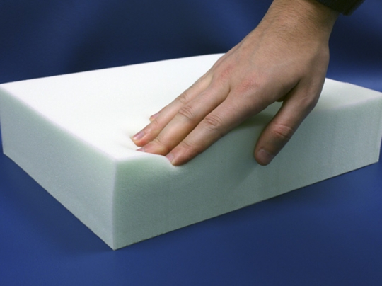

You will need to add some foam around the hot spot (but NOT on the spot) to reduce the pressure to that point, (so that the pressure would be spread evenly, all across the head), NOT to depress the EPS liner in the hot spot area , or cutting off the foam(to make the foam padding thinner in the hot spot area), which, will make the matter worse.
You can find foam at local craft store, hardware store.
But if you want something more professional like result, buy open cell foam from the company like this.
That way, you can choose the foam with the thickness and the density you want.
https://www.foambymail.com/open-cell-foam.html
As for adhesive, I recommend 3M super 77. (Available at your local art store, or industrial plastic store. It is also available from the link above.)
https://www.foambymail.com/3M/3m-super-77-spray-adhesive.html
BUT, don't use the glue until you are completely satisfied with the result.

This video shows (a little bit) about Arai’s fitting service.
Basically the same job as SHOEI’s Personal Fitting System.
The sponge work starts from 1:38.
https://www.youtube.com/watch?v=8JMFqcO2zYI&feature=youtu.be
Adding foam to the top and the back
Left is original, adding extra layer of foam to the right side
Arai RX-7-X comfort liner (stock), comes with two-layer removable sponge at the temple area.
SHOEI X-14 with added foam on top

The example
Dish washing sponge
Cut into half
Place on top of the head (between the center pad and EPS liner
But, that’s going to block air flow (of the top vent system). so ...
punch some holes through the sponge ...
Done
That’s good for the experiment, or temporally fix.
That sponge on top of your head may be good enough to be permanent fix in some cases.
If you need more fine tuning, here’s the basic guidelines. (what shape of foam, what density (hardness), where to put the foam)
Adjust the top (helmet height) first.
Then, side (temple area),
forehead last.
If you want just a little bit less pressure in the certain area, instead of buying multiple different thickness and density foam,
you can punch hole(s) through the first layer of the sponge pad.
Punching holes makes the same effect as lowering the density (perforated area springs back less than solid part.)
You can find a punch set at your local craft store.
https://www.joann.com/realeather-mini-punch-set/10208106.html
(in my sketch, I drew a single big hole, which you can cut out with craft knife or sissors. But you may get better result with multiple small holes. It all depends on “how big the area you want to reduce the pressure”, “how tight the space is”,”how much pressure you want to reduce”, etc.)

Incredibly thick comfort liner padding
Well, I have to take the helmet out and measure, to give you the precise number, but it’s around full 1 inch thick on these AGV, as opposed to Arai / SHOEI’s 7- 9 mm.
Wearing these AGVs is kinda like this.
You don’t feel the EPS liner at all, because the padding so thick and puffy.
Wearing RX-7, X-14 is like this.
You (somewhat) feel the EPS liner, because of thin padding. Therefore, right shape, right fitting is way more critical on these helmet.
