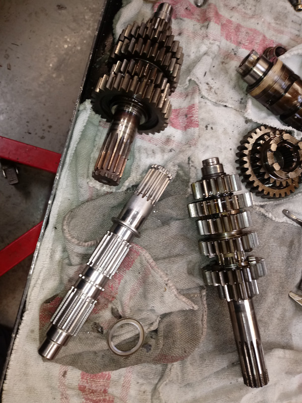

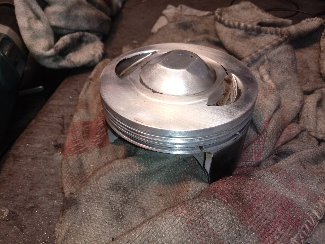

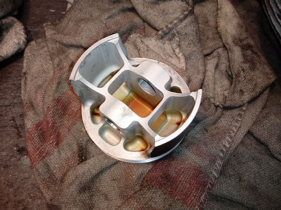

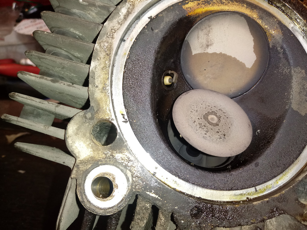

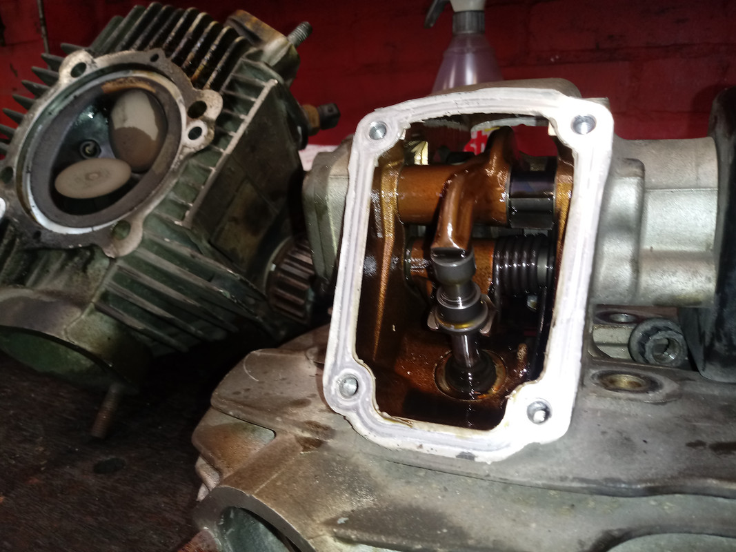

Heads: valve seats refurbished, valves refurbished, one valve guide drilled and put in sleeve, seals replaced, cams saved, five rockers replaced
Cylinders: another 20-30,000 km of life left. New nicasil or something else....
Pistons: no cracks, all rings good, compression test good
Crank and rods: good
Gear box: output shaft replaced because of wear under the sprocket, gears a little worn
Cases replaced: crack by the belt drive, crack at front right motor mount

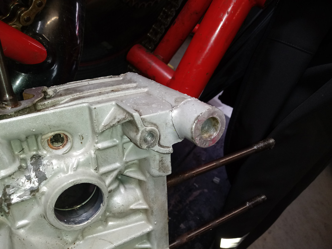

Starter 'clutch': spinning a little, replaced
Runs: ~10 degrees C hotter, 10% better mileage
Issues: not-perfect intake port & polish rom previous builder holds it back, oil leak rear right cylinder vs cases (the usual place)(plugged, but still leaks)(updates to follow)

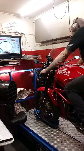

All finished? Dyno results?
2004 GSXR 750
Posts: 8912
S2R 800 '07
Re: Rebuild (another) at 195,000 km
July 28, 2020, 04:00:53 AM »
Quote from: koko64 on July 28, 2020, 03:49:45 AM
What do mean? "Finished"?
Back to the ~99 "Ducati calculated" bhp.

Are cracked engine mounts common on the high mileage bikes?

Quote from: Charlie98 on July 28, 2020, 10:08:01 AM
Not to my knowledge, but this might be connected to a big track highsider. All engines will crack sooner or later, so old age might be the reason...
The more common crack area is behind the belt drive shaft / front of main bearing.
