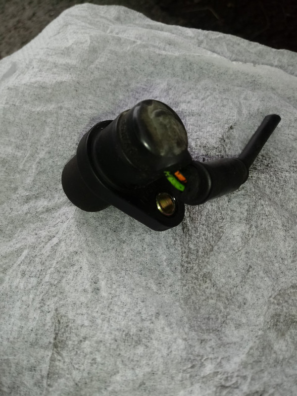

So, I bought a swingarm years ago. It included all the stuff the owner wouldn't be bothered taking off.
Fresh sensor  [thumbsup]
The rubber boot/sleeve was torn.
If it stays dry I'll test it tonight. Good methodical work  8) I'll get an answer about the sensor. The battery will be next - if that's what fixes it, we'll know less than if it's the more obvious sensor fail, but more than nothing

#9
Rock steady   [thumbsup]
