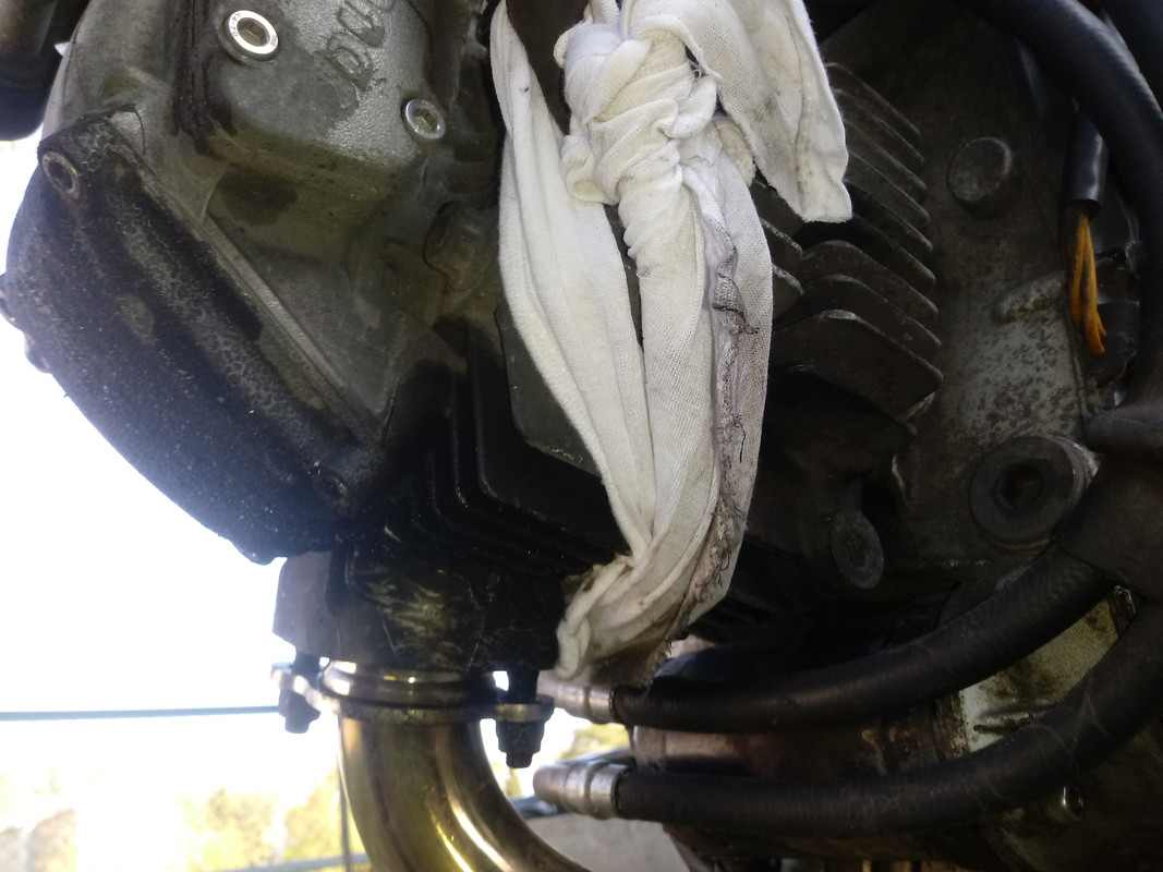

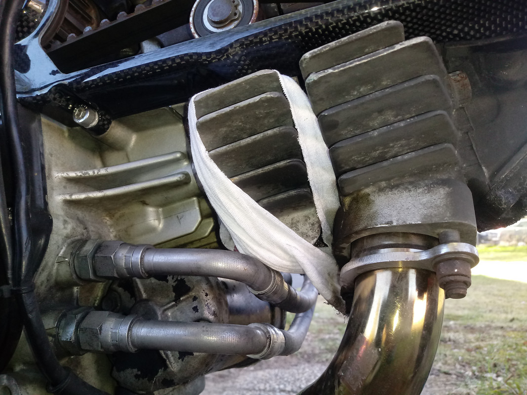

Dripping from the horisontal head/cylinder junction - the cooling fins under it. Oil on the exhaust, oil cooler lines, starter motor and during a ride it spreads. It may have started last summer (the oil mess was there then - but less).
I have planned to replace the cylinders this year, in July. Usually 5-6 thousand km from now.
Any ideas other than to remove it and replace o-rings?

You could try retorquing, but it probably won't help. Is the breather in the original location? if so, that could be the problem.

Quote from: Howie on May 07, 2022, 09:57:03 AM
Retorquing is easy enough, so I can do that.
Breather in it's normal position and it sweats oil. However - it has done that before and much more than now - without ending over/around/under the front cylinder.
