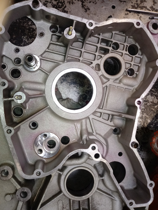

I'm doing up a 1996 Monster 750 that is only showing 13k miles (I'm still not sure if this is genuine).
I did a compression check with the engine warmed up I got 120psi / 8 bar from both cylinders. I put in a few squirts of oil into the cylinders and it did not change the readings at all.
Normally I would think 8 bar is pretty low and probably shows that something is wrong, but the service manual quotes "standard compression" 9-11 bar and "minimum" 8 bar so actually it is in spec, just about.
Plus the compression ratio is only 9:1 on this engine anyway. It's good that the cylinders match, and that the test with oil added was the same as that suggests the rings etc are fine.
So then I checked all the valve clearances. The horizontal cylinder was very close to original spec, the closing shims turn freely with the arm held down but with no significant clearance and the opening ones are close to target. But on the vertical cylinder it's all a bit loose with one out of limits (see pic). I didn't want to get too deep into removing the shims and belts etc yet so I only measured the one that was out and will just replace that for now.
Given the compressions readings are the same for the two cylinders, I don't think the loose valve clearances on the vertical cylinder are a problem.
What do you guys think? Is the motor good to go or not?
