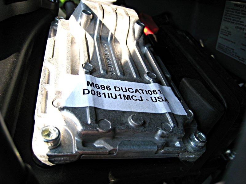

SteveH
Hopefully someone can help me out.....
Here is a photo of the ECU that is on the bike right now - the supposed Ducati Performance one...That doesn't display 'M696 RACING'
Anyone have a photo of the DP ECU ?  Board Sponsors perhaps ?

So at this point, I just would like to know what is going on.  It is still too early to say about fuel milage, etc...So all I have to prove my case in one way or another is to see if the P/N on my ECU is the same as on a stocker or not.

Quote from: SteveH on August 10, 2008, 02:22:18 PM
Steve, how far did you ride the bike after the shop... that part looks used? or is it a bad photo. The new part should be pristine.
