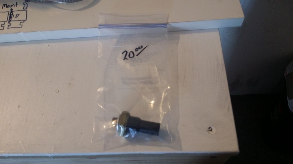

I went and picked up the oil pressure sensor yesterday.
It was a local place and the guy had a spare 750 engine in the back, so he pulled it off and sold it to me for $20.
He was a really cool guy. The shop's name is Irish Mike's. I would HIGHLY recommend his shop to anyone who lives in Las Vegas, Nevada. PM me if you need more details on his shop.

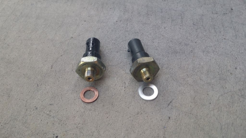

Here is the old defective sensor next to the new one. He threw in an aluminum crush washer ilo the copper one, but it ended up being too big so I used the copper washer.
I put it on and started her up. She is running dryer than an 90 year old granny's P#^$!! I think I might name her Mildred.
I adjusted the idle screw on the carb and she is running sooooo sweet!

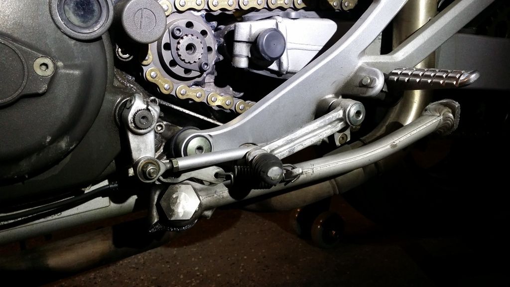

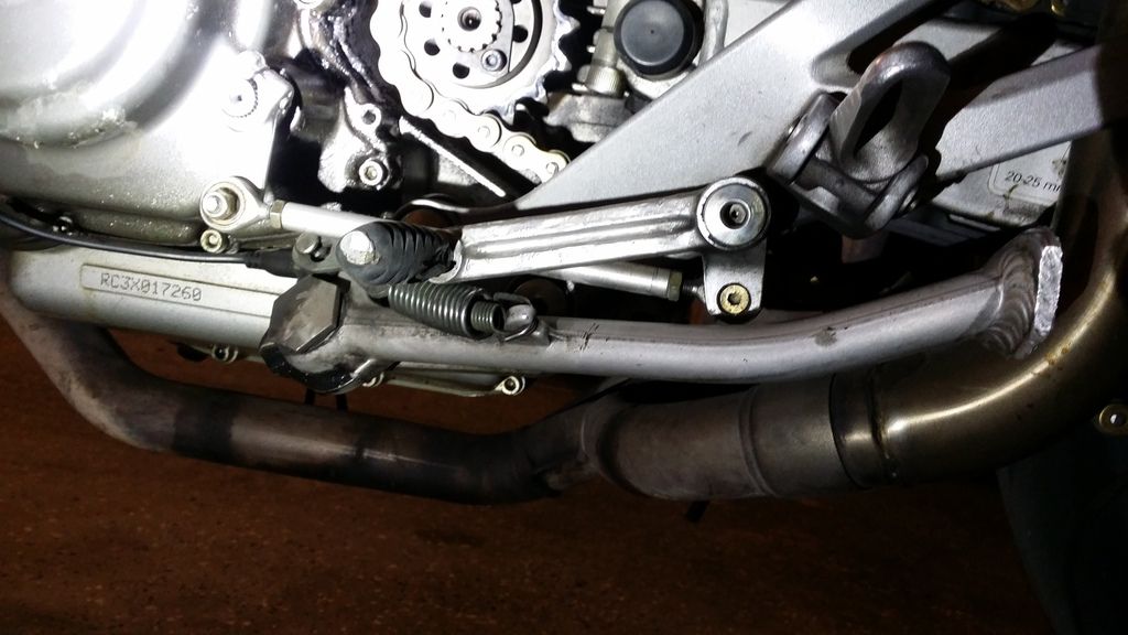

Second: The shifter is binding up on the spring for the kickstand.
When I downshift, it will get stuck on the spring and I'll have to kick it up with my toe.
Here are some pics.
Does anyone have any pics of what it is supposed to look like?
No blink is probably the flasher, one of the relays under the seat, either 2 prong or 3.  Can be purchased at any parts store.  Shit lever looks bent to me.  If you remove it and bend back carefully you might get lucky.

First of all, I'm very jealous that you found an M750 for $400. Looks like a fun project. Shift lever also looks bent to me. Your kickstand/spring also doesn't look OEM to me. I just walked outside and snapped a picture of my shift lever from above with the kickstand up for reference (2000 M750).

I would just replace the whole side stand. Probably a few on eBay.
brad black
gear levers catch on the round style side stands when they've been bent in.  common issue.  bend the lever out gently, otherwise it'll crack and then break.
