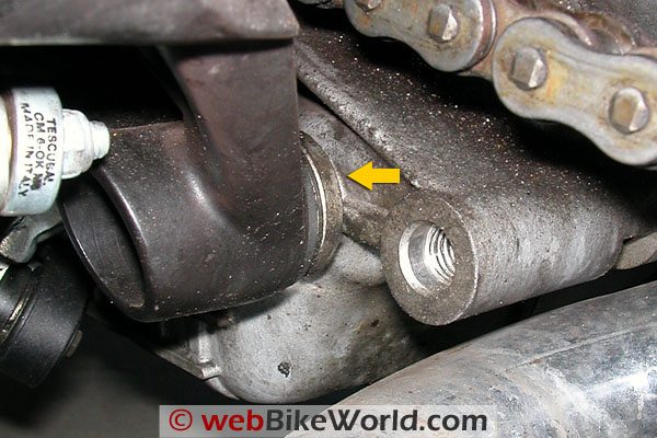

I tried to install today and through bolt is blocked on right side. Correct me if wrong but stand is mounted using reamost rearset bolts and the through-bolt
http://www.webbikeworld.com/ducati-motorcycles/gt-1000/center-stand/gt-1000-center-stand-mounting-hole.jpg
next. There is a threaded brass fitting installed on the right/opposite end blocking the through bolt. It mounts a holder for the gas tank vent hose. Do I just bang it out with drift?
