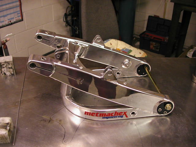

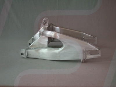

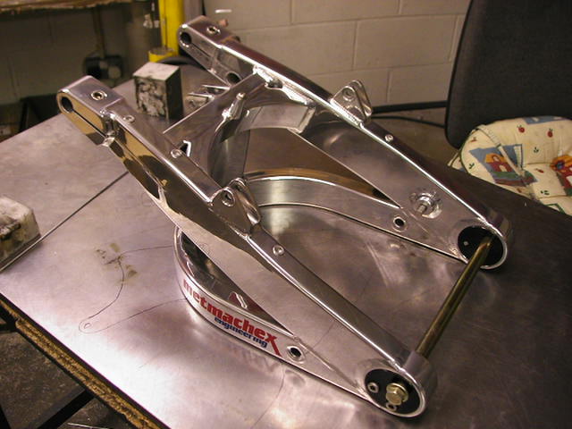

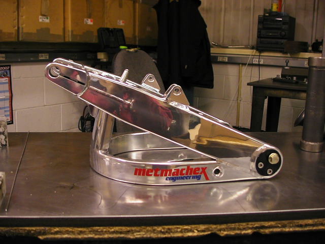

I've only begun dealing with this company (
http://www.metmachex.net/
) and have been really pleased so far. There communications back and forth with me, though always a day-delay for time difference, are great. I'm currently investigating options for both my hooped 900M and a future 900SS. My Monster is a 99, so it has the 851/888/Monster swingarm. This company offers both a standard direct replacement and a braced option. It comes high polished and with eccentric adjusters.
Somebody help enlighten me as to pro's/con's of eccentric adjusters and general user experiences. Also, if anybody has experience with this company and their swingarm products in general.

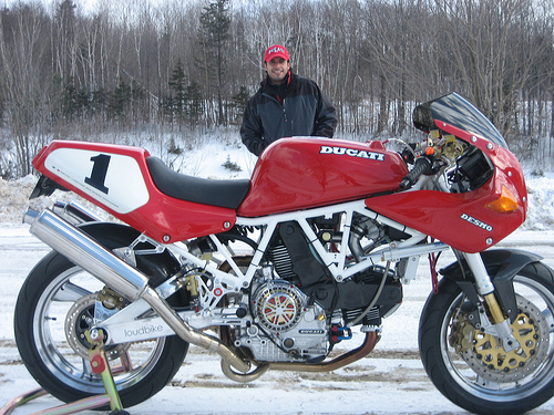

I've seen one of these on the drool worthy 900ss below:

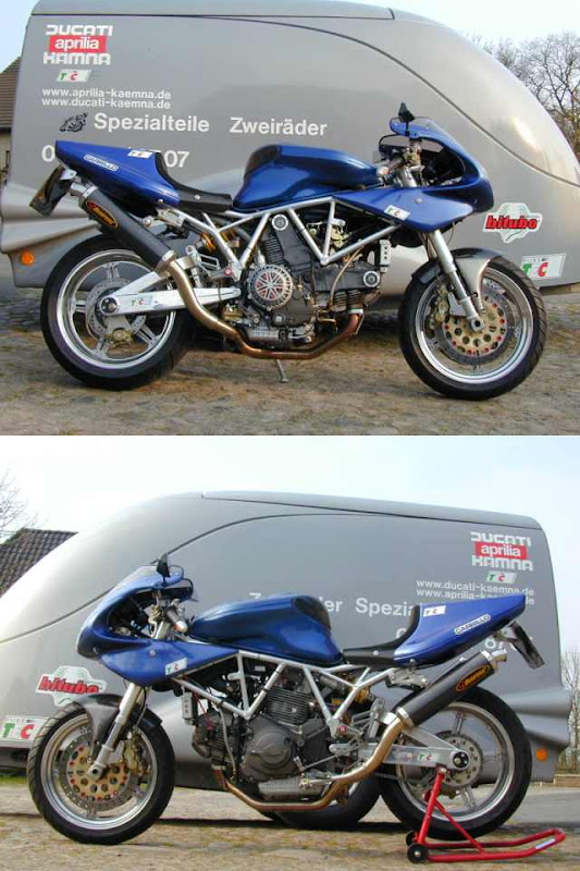

and from Kaenma.de:
Braced 851/888/Monster
Non-Braced 851/888/Monster
Febur Competitive Offering for 900SS: FE483 (at more than triple the price, for aluminum still!

Eccentric adjusters are great. However, adjusting them changes ride height, although I've never noticed a difference.
On the design shown above, how do you rotate left and right eccentrics the same amount?
I've considered such a swingarm for my Bandit. Just because of the eccentrics, but on the double-sided swingarm, how do you rotate left and right eccentrics the same amount?

If memory serves (albeit from swingarm.com), there's a tool that fits into
one
eccentric to rotate it. It seems to me that would rotate the two eccentrics differently. I'm pretty sure that I'm missing something.
