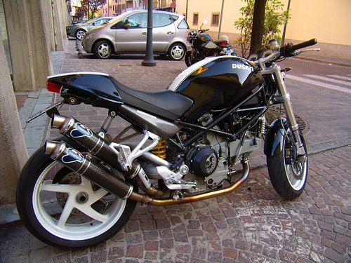

JustMike
Posts: 46
Re: 50mm for s2r 1000?
October 23, 2009, 04:53:39 AM »
Quote from: turbowagon on October 23, 2009, 04:40:01 AM
Does the full termi system for 800 includes the header?
Is the connector to the engine also 50mm?
It look to me when they sell the mid pipe for s2r 800 or s24, they start after the header. But for s2r1000 they sell the mid pipe includes the header.
https://www.fastweb.co.uk/spaceshack/cart/index.php?main_page=product_info&products_id=4
In the last post your pictures show that the marving goes from the head to the s-pipes, (and it will work with stock s-pipes and mufflers too) so the s2r 1000 system WILL NOT fit s4r and vise-versa
I guess I'm confused now with the question, But I'll ad that the the system for the 800 and s4r differ at the head because the 800 is 2 valve (as the 1000 is) and the s4r is 4 valve, I think what happened was they built "most" systems to accomidate both engines? then built the when the 1000 came out it had the one piece front header? so built yet another system.
Here is my Marving with the Arrow slip-on's which will be up for grabs when I get the full 50mm system on, btw it has Carbon cans Now
