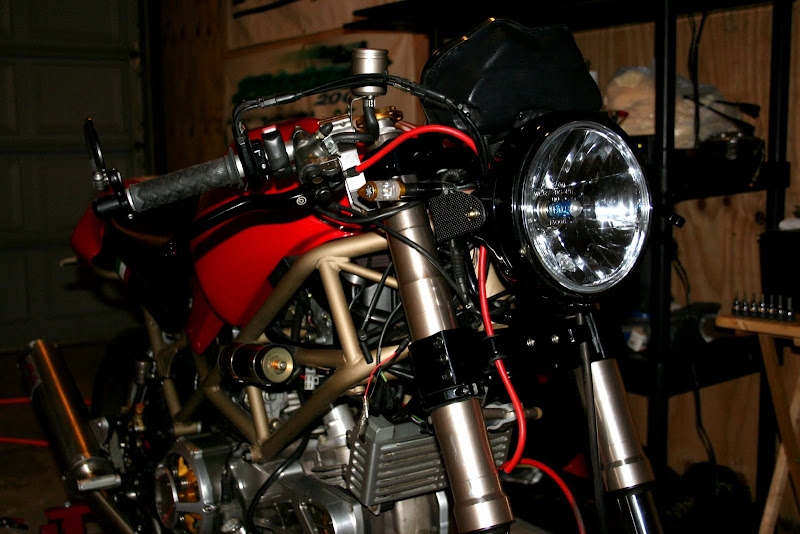

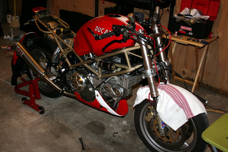

Before...
At some point, you'll be at this stage, I call it "half way"
(Crackberry Pic)
Then...
Then...
The "After" shot is soon approaching. Should be 'done' with this project near Jan 1.
