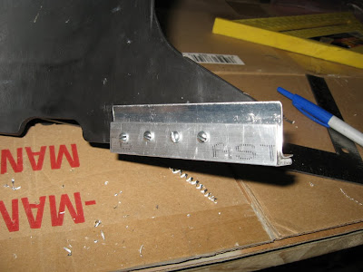

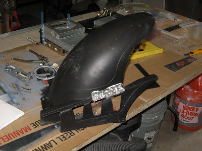

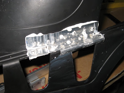

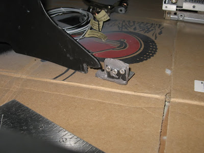

What a damn shame that Ducati made the rear hugger out of crap plastic. It has now broken on me 4x. Consequently, hacked back together 4x's. What a pain. Not sure i want to fork over hundreds for a carbon fiber one either.

Is there a hugger and chain guard made out of Aluminum available? I love Al, which is what i used to patch it up with. If i had the time to make one several times before i got it right, i would make one myself. :)

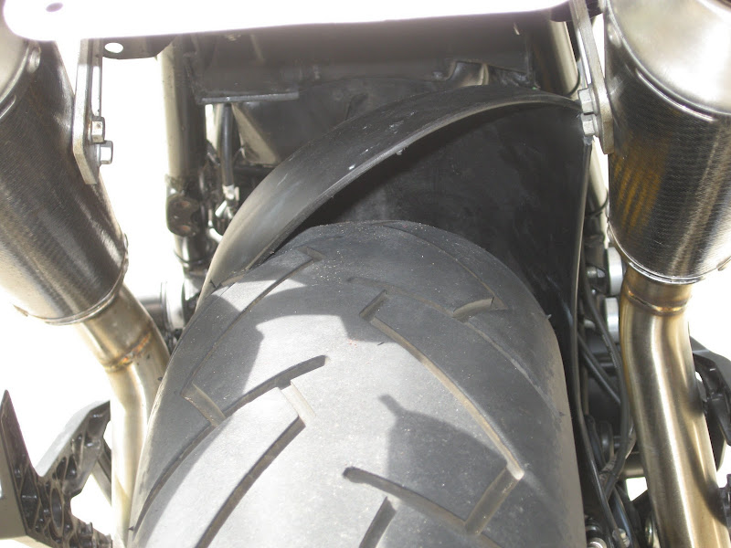

I think you're on to something. Check out the photo above? I did a short test ride, less than 10 miles. 5 miles to lunch. Unfortunately, i forgot to check it while there. 5 miles back but this time with highway speeds. That's what I had staring back at me when I returned. Fortunately, it didn't break this time but distorted the hugger out of whacky shape.
I still couldn't figure this mystery out. This time I had someone look at it with me to get a fresh pair of eyes. They had me sit on the bike and bounce around. They said that they could see how the hugger could now get hooked onto the muffler attach bolt head. Before, there was no physical way I could possibly move the fender up that high, and it didn't occur to me that my weight while bouncing around could potentially play a part.
That explains the vertical distance. Still doesn't explain why the hugger would move horizontally to snag. Now i need to figure out how to put a blocker over those bolt heads to prevent snagging.

Also, i forgot to mention, no marks on bottom center of hugger. Thus, at least it's not bottoming out on it. However, you can clearly see how it's ground out a huge part of the hugger on the left side, where it's been rubbing against the tire, when caught up.
