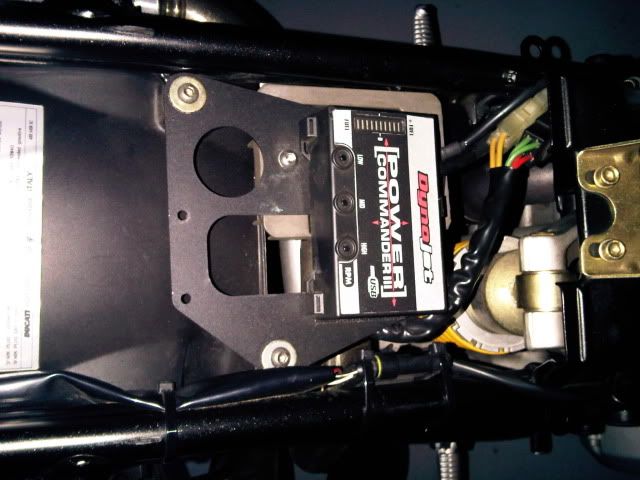

anything thick enough so that it wont bend or defelct onto itself is fine.
for aluminum id go for 1/8th inch. it can take a nice hit by a rock and not dent. plus aluminum is a pretty decent heatsink. throw some CPU gel in there and u got ur self a nice fat make the beast with two backsing piece of heat sink.
this is pretty much how mine looks like. just straighten it up, and drill that other hole.

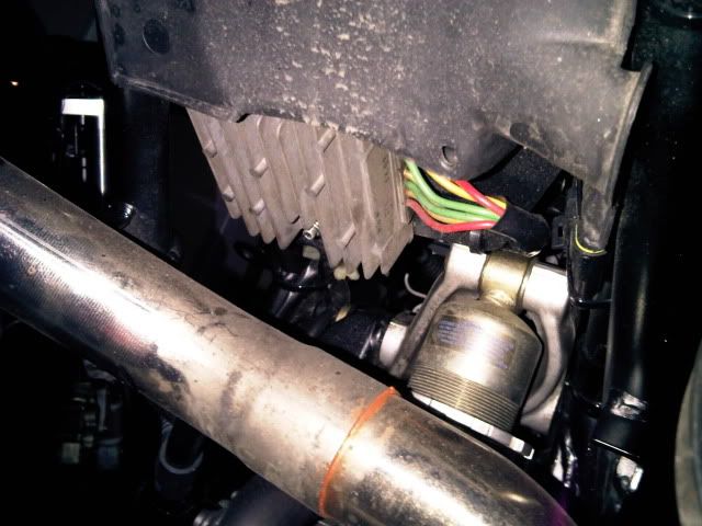

all i did was just flip the rectifier so that it sat underneath the fender. had to drill a couple of holes through the plastic, but that was it. I painted it black so it could blend in tot he fender. if you have your rear tire hugger, you shouldn't have any issues with rocks and stuff flying up on it.

wow, now we're cooking. thanks guys. much appreciated for all those pictures. now i can go do some mods.
