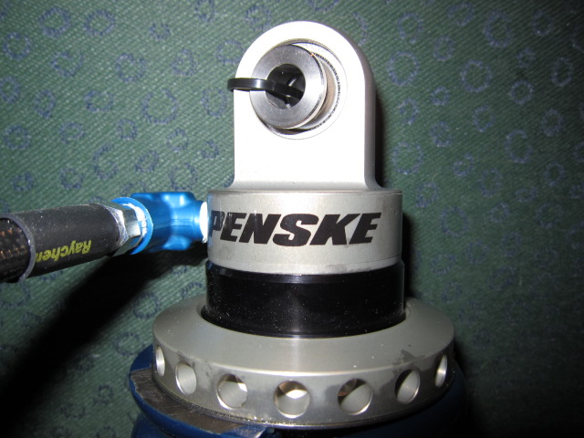

When installing your shock, make sure to check for interference between the top of the body and the rocker arm, on the right side.
Penske seems to be insistent on fitting a top eye on the shock that's too short.
Like this, and note, the top bolt isn't even in:

Speeddog, if there is an interference as you show how did you solve the problem? Dremel grind the rocker arm?

Well, it was a customer bike, so I wasn't comfortable with relieving the rocker.
Sent the shock back to Penske, had 'em put a longer eye on it.
Hopefully they're not still sending them out with the short eye, but I've seen a recent Penske shock that had the issue.

This shock I ordered from TD was specifically for my S2R1000 so I hope it all fits. They should know. Right? I checked it and the fitting is located 90 degrees or about where the N is in PeNske in your picture. The fitting is the same 90 degree fitting. The top of the shock is machined differently so it maybe the correct length not to interfere with the rocker arm but it looks like the fitting will interfer with the black plastic part just to the rear of the shock. I'm doing the swap in two days. Fingers are crossed.

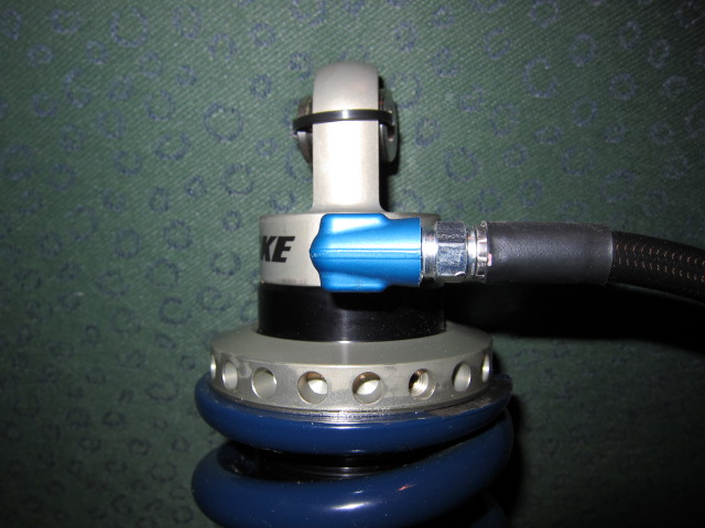

Can you post a picture of the top eye of your shock?

Here are the pictures.

Yep, you've got the longer top eye.
Hopefully that's straightened out for good...
For reference, here's the short one:

I'm still concerned about the fitting interfering with the black plastic part adjacent to the rear of it. It think that the fitting on mine needs to be 90 degrees to the left side as your pic shows. Gee, I hope this goes well but I don't get a warm IZ_ feeling it will. I'll post my findings.

IIRC, I've seen pics of a Penske with the fitting on the back, like yours.
It comes *very* close to the breather tank, but doesn't hit.
