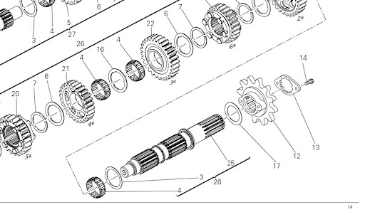

Dont know about 696, but on my S2R 800, the engine sprocket is held in place by an oblong plate the locks into the splines and attaches to the sprocket with two small bolts (8mm?). If those screws come loose, the sprocket can slip in/out on the splines. I am assuming that this being a new bike, you havent had to touch the sprocket, so perhaps the screws were improperly tightened at the factory. I just replaced my sprockets for the second time (22K miles) and used blue Loctite and torqued the screws to the manual specified value.

If the two bolts were tight, then the locking splines are gone. If the splines are good and the bolts are tight, then the plate holes for the bolts are loose enough to allow the splines to clock and unlock. The locking splines on the plate will wear, but it shouldn't happen at your miles, Mike.
When you get it fixed, ask them to safetywire the two little bolts. I actually prefer the plate/spline/bolts sprocket holding mechanism over a tight bolt on the splined shaft.

this is about as robust a system as you can have. There is some special cause to your problem (sprocket installation backward or wrong part)

Thanks for the diagram.
Apparently i have proof that it isn't robust. I believe that robustness is when something is not quite right, say a bolt not torqued perfectly the whole system should still stay intact. I now have 3k in damage and no real explanation as to why it happened.
