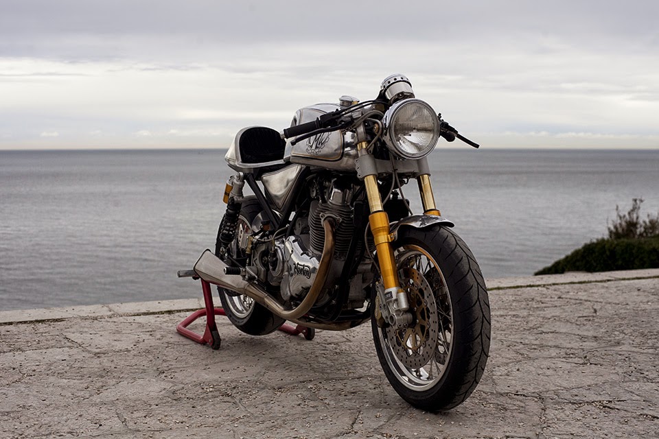

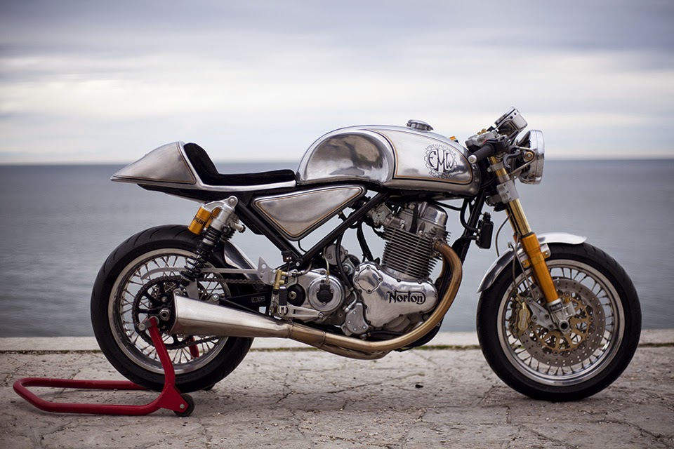

Quote from: brad black on May 10, 2014, 06:33:28 PM
the triple does it for me.
http://www.bikeexif.com/custom-triton-motorcycle
Although a very heavy motor, those old triples are incredibly torquey and leave the twins for dead. Very impressive motor. I deal with two T150 Tridents and the motors hold up to real world riding. The weight is kept low in the frame though. I know a guy who sold his street triple and instead rides a restored T150 with modernized ignition and electrics. It seems you need to add another disc, jet the middle pot a little richer, rewire them and get an aftermarket ignition and they go well. After riding both I understand. Never thought I'd say it, but I'd have one over my old Bonnie any day.
If that Norton frame drops a lot of weight,  then that would be a great bike.
