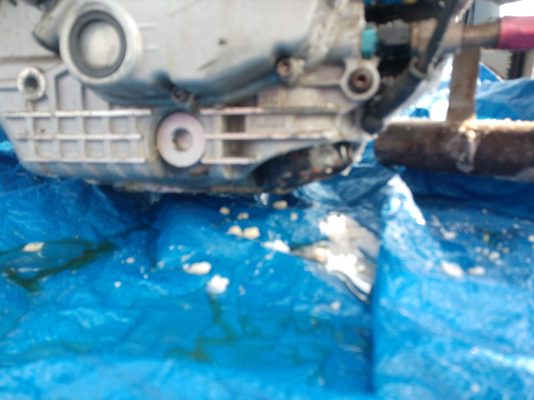

Well... let's see. A bit of weinerstomping while loading the bike at the end of Monday ended with a hole in the oil filter. Ordered one at the local carquest, then drove to SLC (1.5 hours each way) to get one.

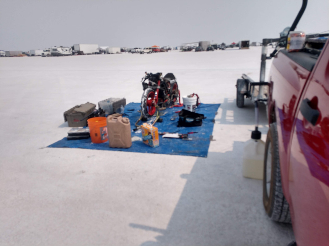

Arriving on the salt
First pit setup
Oil filter carnage

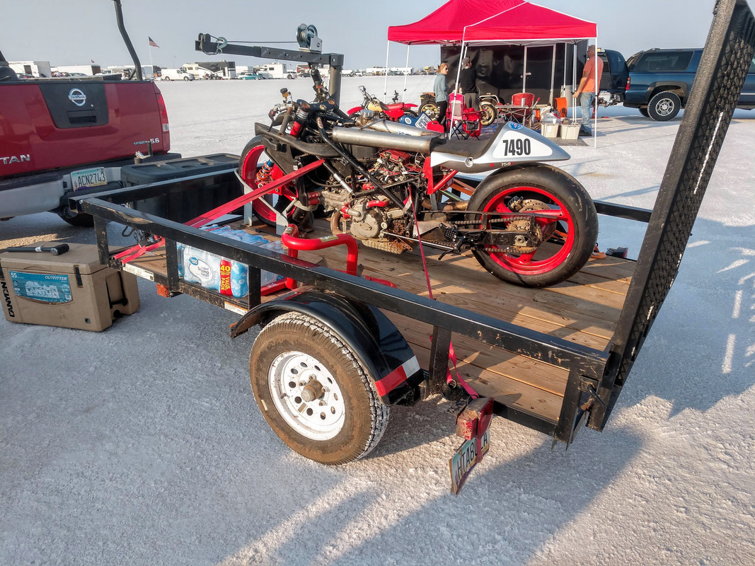

Obligatory start line shot

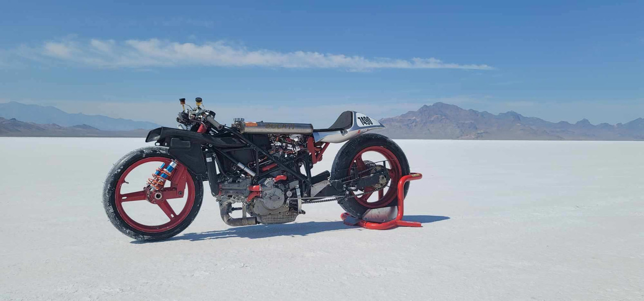

Obligatory empty salt shot
