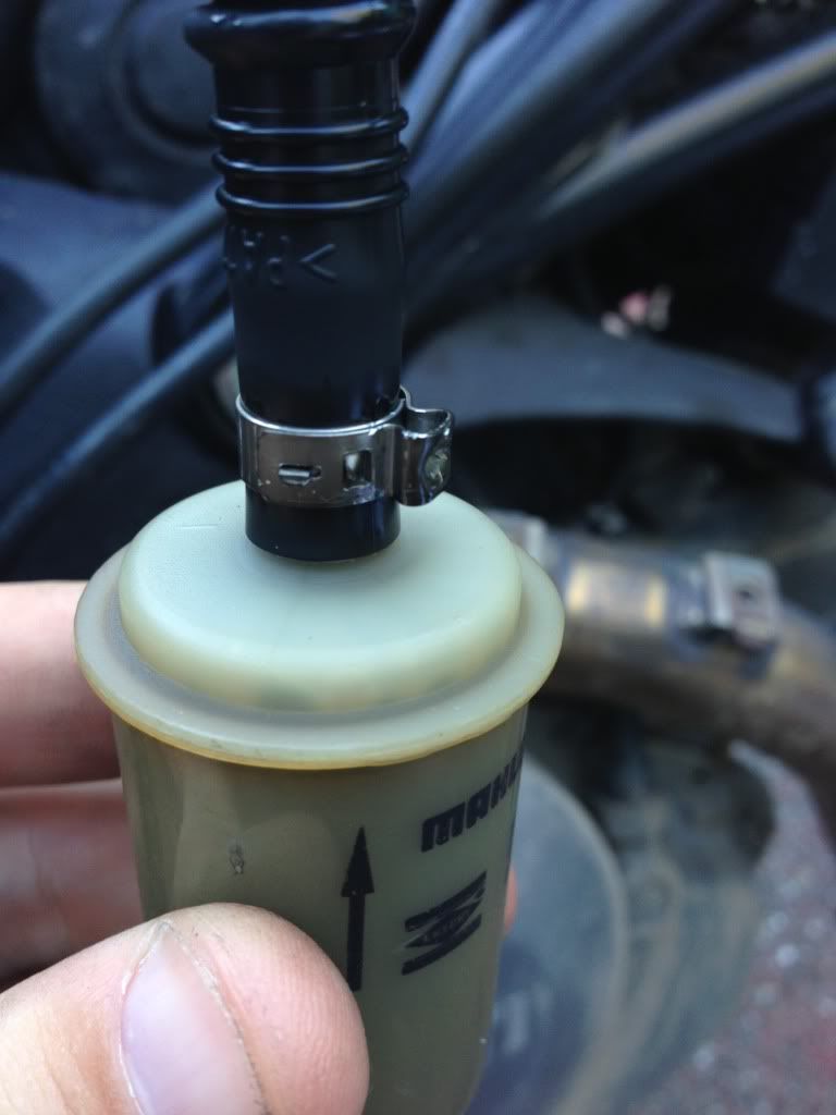

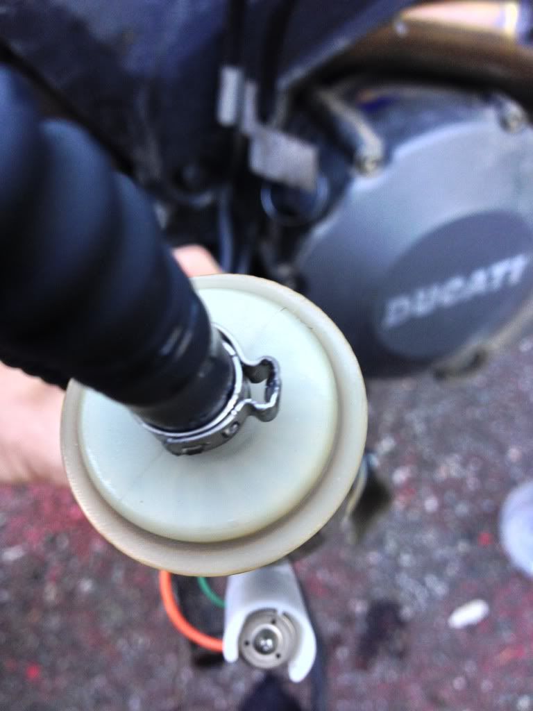

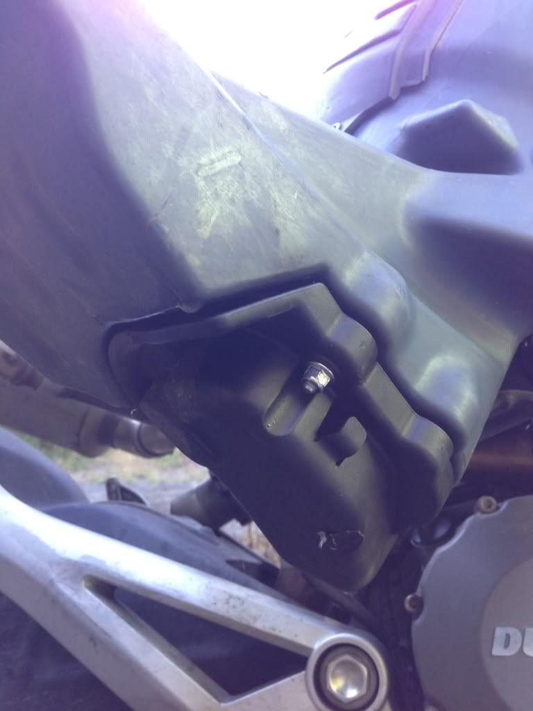

So I am trying to change my fuel filter. I searched far and wide for a guide online, could not find one, so I decided to just dive in and try it. Never done this before on any bike. I've had my tank off before so I figured that was probably he hardest part.
So anyway, I got it off, took note of where the fuel filter assembly is, and started to undo it, these bolts visible in the bottom here:
As I started to loosen the first one, this happened:
I tightened it back up shortly after it started spewing all over the place, but I'm wondering if I'm make the beast with two backsing this up already?
Is this whole assembly submersed in the tank? Do I need to have it completely empty before removing it? I thought I would pull the assembly off and disconnect a line and I would just have to plug off the line with a golf tee. I currently have about 1/8th of a tank in the tank.
Please help the noob mechanic.

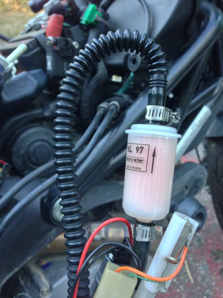

I installed the new filter, put it all back together the same way it came out, but now I've run into another issue.  She just won't start now.  I just get a repeating clunk clunk clunk clunk sound.  I made a video:
Ducati 696 won't start after fuel filter change
No idea what this is about.  As far as I could tell it all went back together easily and exactly as I took it apart.  Is there some step I might've missed somehow?

pump priming?
filter in the correct position?
fuel in the tank?

- The pump is priming when i turn the key, yes.
- I believe it is? There's only really one way to put it in.  I replaced it exactly as the old one was.  Below is a photo of the new filter in place before i put it back in the tank.
- There is fuel in the tank, I dumped a 5L jerrycan of fresh fuel into it before starting it.

I can only suggest open and close the ign switch not the starter a few more times to get fuel all over the system then try again
Did any fuel get to the fuse box during dissembly? Any hose kinked?

Confirm that your battery cable connections are clean and tight (not too tight, the battery terminals aren't bulletproof).
Confirm that your battery is fully charged.

I tried cycling the ignition a few times when I was first trying to start it.  Had the same thought process as you on that one.  No avail though.
I don't think any fuel would've got on the fuse box during disassembly.   Tank was pretty clear of the bike during that initial leak I had.  I'll check for kinked hoses tomorrow as well, but again I don't think so.

OP: it might not hurt to check the relays as well.
Oh, and from a novice mechanic to a beginner mechanic, my advice is to check things going from simple stuff to complex and retrace your steps.
