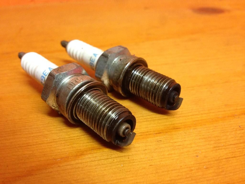

I'll take a plug off and take a picture.

One plug looks too rich, not sure about the other with the light.
I have found 60 slow jets way too rich, but that's with kangaroo fuel. Nick will have the better base line specs to try for your mods. Too rich slow jets give a great cold start then clag the plugs once its warmed up.

Are those plugs 8s or 9s in heat range? 9s may be too cold. Most people I know run 8 in NGK heat range. Could be as simple as that.
The pick up also needs to be a certain distance from the Flywheel trigger as it comes round. Check the Haynes manual on procedure. The Haynes manual has the spec (I forgot). You use a feeler gauge and set it by moving the bracket in or out a little IIRC.

You need 8's for plugs Chris. 9's are way too cold.
