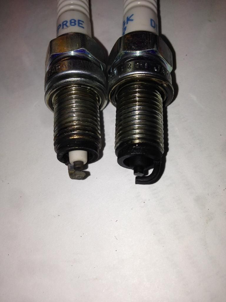

More bad news. Took the bike out, 20 degrees warmer today and it ran like crap. Felt the whole time like I was dropping a cylinder, so I immediately checked the plugs when I got back to my garage:
What do you guys think the problem is? The carbs are tuned exactly the same, and I've even put a manometer on the intakes and gotten good synchronization readings.
Does this look like an electrical problem to you guys? No spark in one cylinder? Way back at the beginning of this thread I didn't have spark in the vertical cylinder. Now the horizontal cylinder is the one that looks rich. Or do you think the horizontal got fouled and so it turned out drenched in black like that?

The fouled (black) plug...powdery, oily or wet and smells of gasoline?
ChrisK
Quote from: howie on March 20, 2014, 11:44:32 AM
I smelled it when I pulled it out and I thought it smelled like gas. Yeah I guess I would call it wet before I called it powdery or oily.
I ran out of time before I could check for spark. Had to be somewhere.

I have spark on both cylinders but one seems visibly brighter than the other. The duller spark has a purple tint to it while the brighter one looks more white.
EDIT: put fresh plugs in and their spark is the same. Any guesses on why I fouled a plug? Current setup is 165 mains, 60 slows, 1/2 fuel, and 1 1/2 air.

I'd suggest figuring out why you have a weak spark before you drive yourself nuts make the beast with two backsing with jets.
