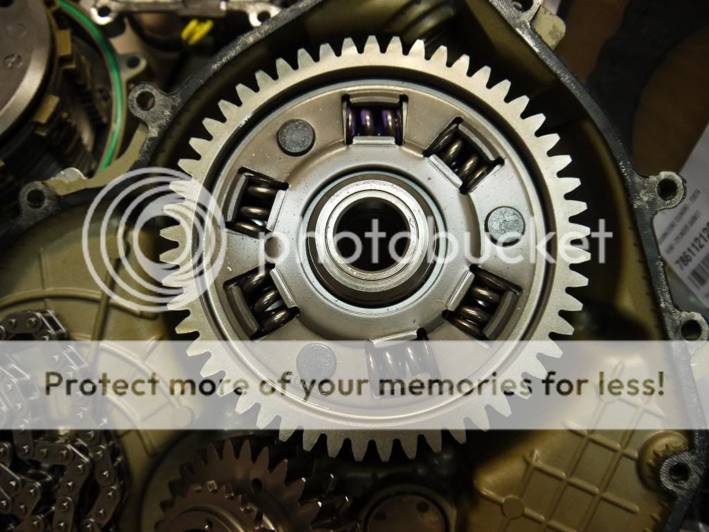

Making the pics work is not going well. Click on the word "venting" in the link and it will take you to the flickr site. You can click the right arrow to see the next image. BTW what is that thing? (I kind of kidnapped my wife's account to post these.)
