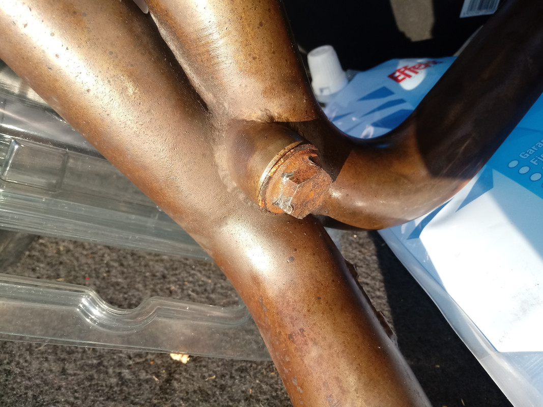

I'm going to have a good fight with the bung/screw/plug in the exhaust (where the O2 sensor could go). I need it in the new mid-pipes.

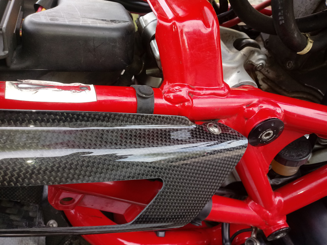

NEW LOCKS and SOME CARBON
I ride a lot and often long rides, sometimes far from people, cold and maybe wet. My bike lives outside and rain gets in... also to destroy any remaining ignition lock smoothness which I fear will end with half a key in my hand on top of a cold and isolated mountain. Previously Ducati sold just the ignition lock with new keys, but now it's only the full set - at, of course, twice the price. It's a great feeling though. Easy enough to replace. Moving the red key chip from old to new red key (that option saved me a new cluster?) Procedure described well in the workshop manual. Done. Well - the seat lock remains.
I painted my carbon covers three four years ago. Great example of how bad a paint job soon becomes without proper prep. Aftermarket parts for this bike isn't as easy to find as in the Monster modification glory days. Now, it's heated grips and communication packages... I found my carbon here and there, higher prices and multiple shipping and customs fees. Another ten years down the road and I won't find anything. Maybe not even OEM. By then maybe I won't be able to find myself. Oh well.

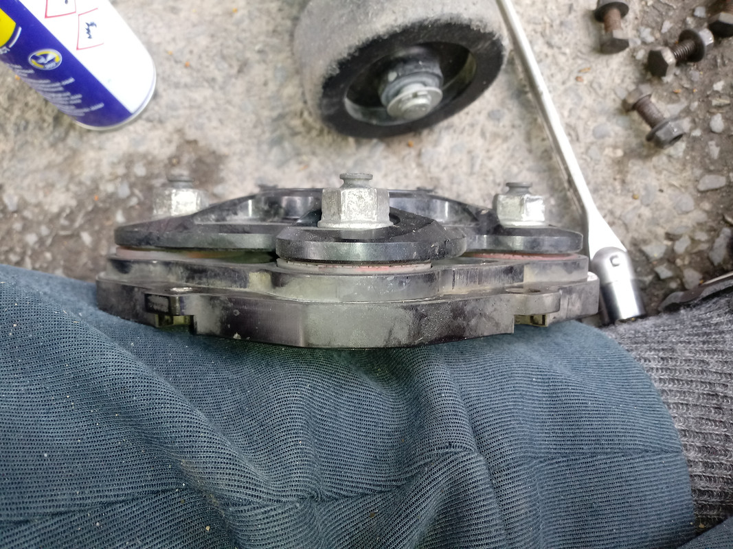

May 22, 2022, 10:15:27 AM »

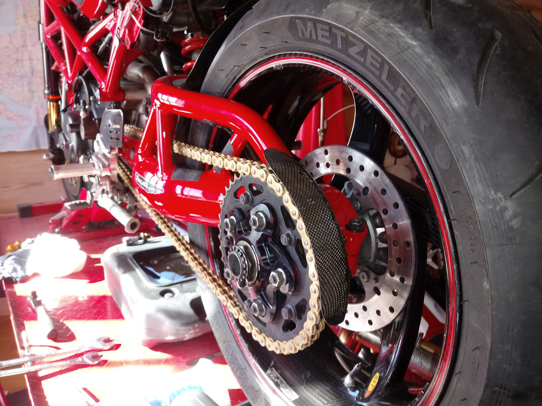

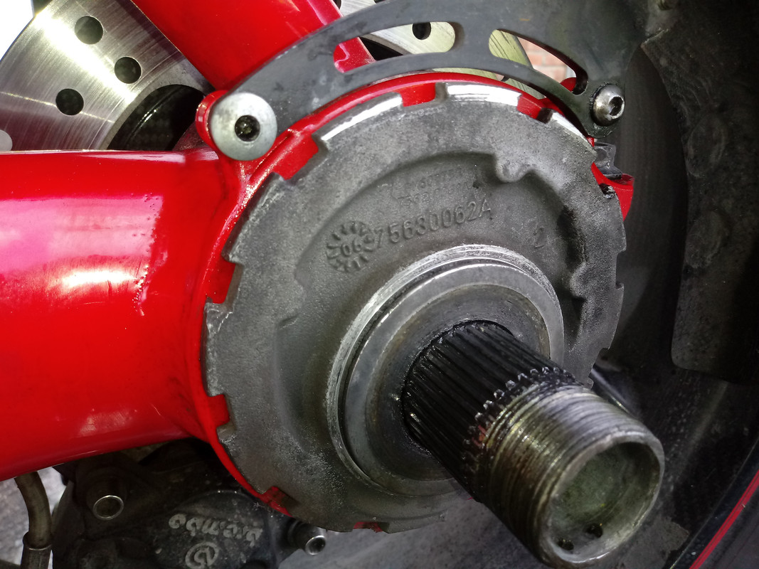

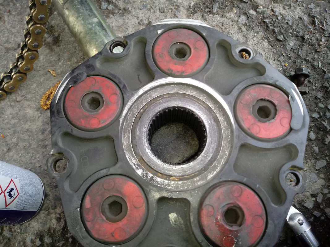

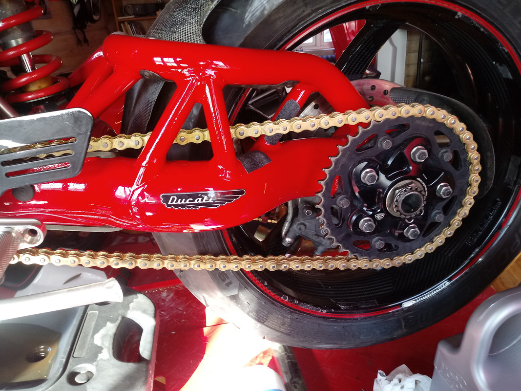

10mm sideways play on the sprocket
Wandering cush drives? No. The tabs are gone, but still ok.
Turns out the 170,000km superlite carrier is really worn. New JT installed. All good
Scary worn and tons of play. No wonder there was movement...
Signs of a little contact
Tabs gone?
Normal play on the cush drives
Always a nice feeling when a job is well done
