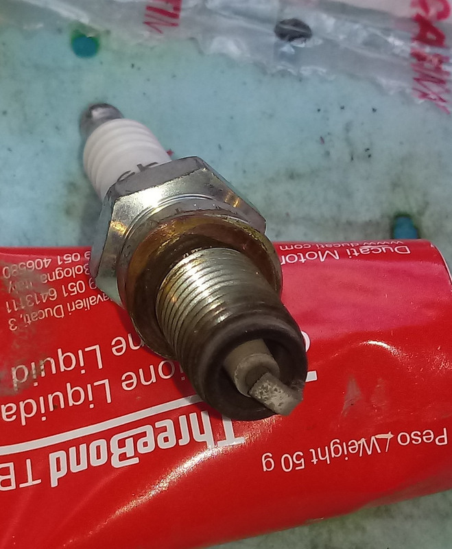

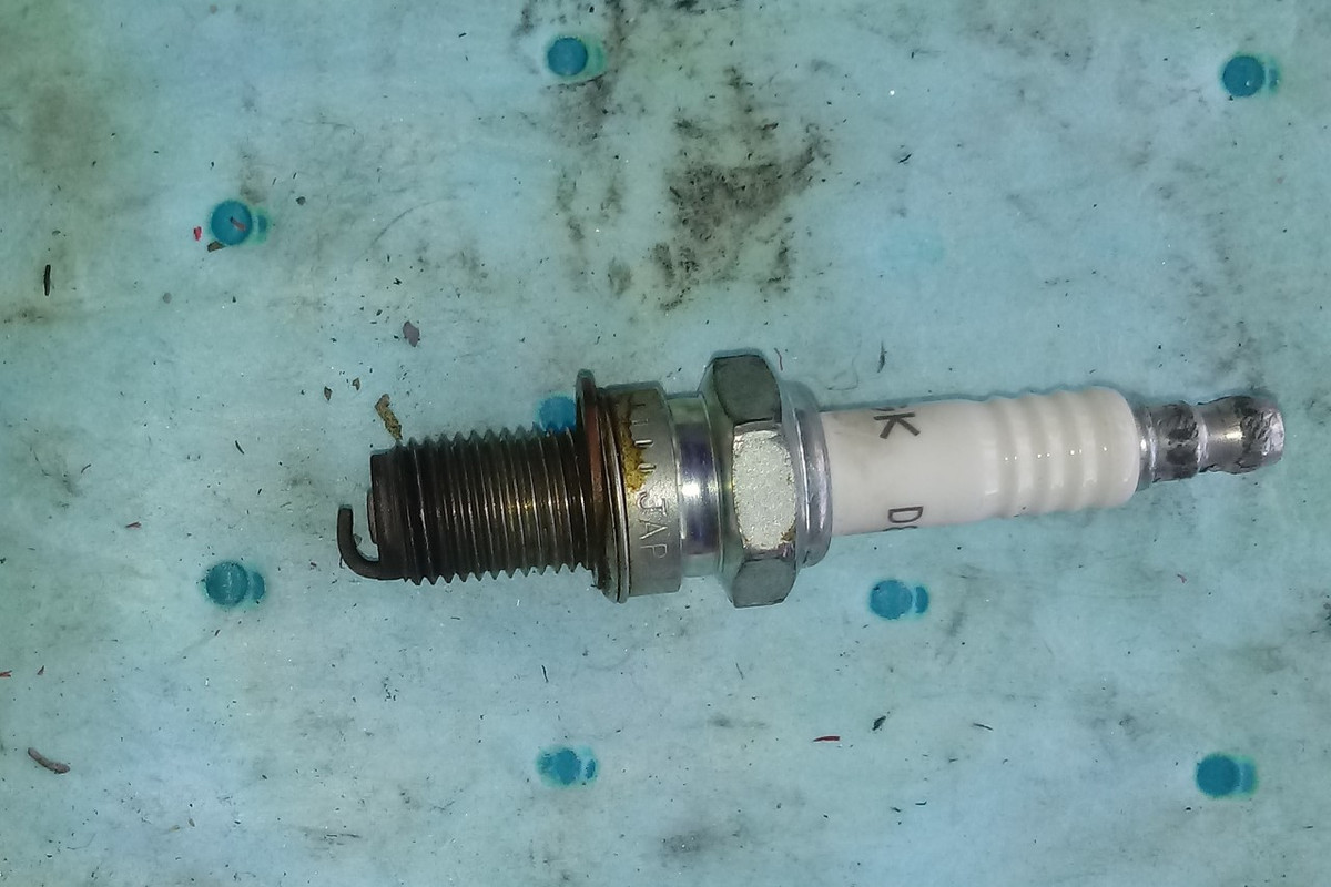

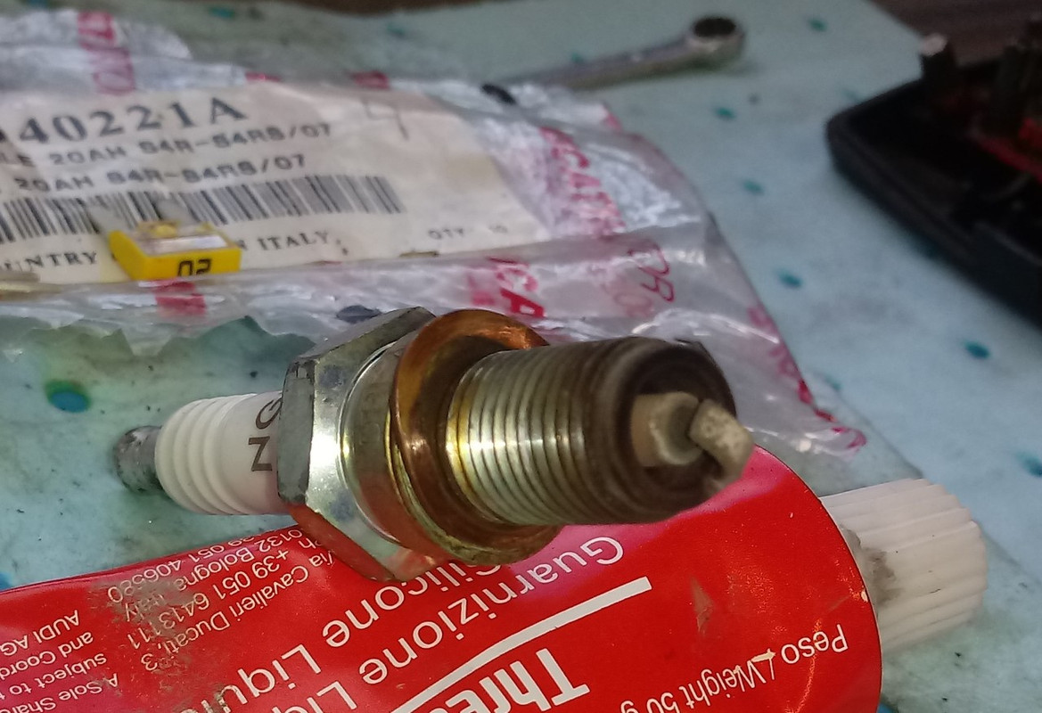

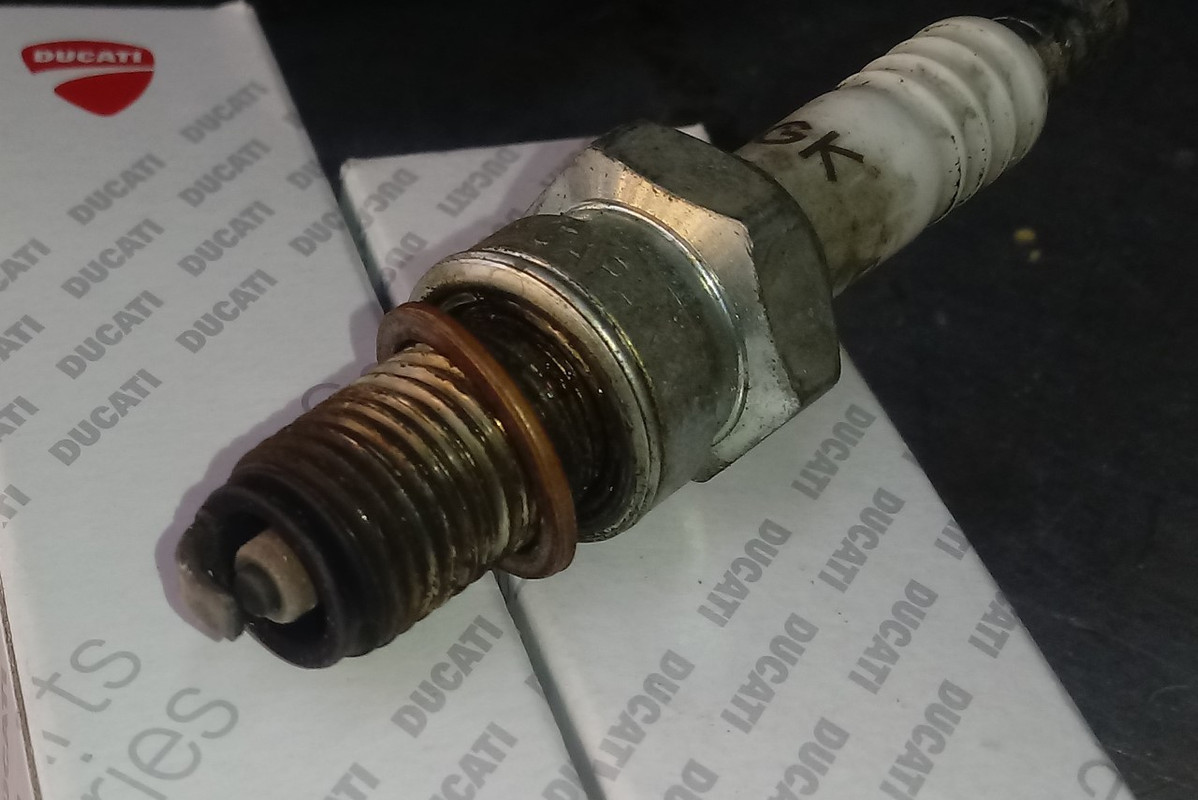

The vertical cylinder's plug is showing signs of lean running. The copper spacer (to lift the plug off the piston) is squashed and maybe there was false air sucked in. You can see that the threads are dry and clean. I don't know if that's possible, but the signs are clear. The other major sign is that the 'tip' from inside the ceramic is no longer a tip. It's gone / reduced down to the level of the ceramic.
The horizontal cylinder's plug is more or less normal.

Shit!  How's compression on that cylinder? I wonder if an air leak has melted it away (or runaway ignition timing issue). Yet the side electrode appears dark. If ignition advance got away it would be white along its length well past the half way mark (unless oil has since stained it dark).

For sure you want to start with a compression test.  If compression is good enough, then injector volume and pattern.  I do think koko's thoughts on the air leak is probably it.  I don't like the looks of the copper "spacer", could be the problem.

Compression was good, but that was without the squashed copper spacer issue (during the test procedure)

I've been around a while, and have never seen a center electrode completely disappear on a 4 stroke, They'd partially dissapear on 2 srokes, and the manufacturers came out with electrodes that would stand the gaff.
Something is going on, and I have no clue as to what it is.

In that case the worst plug might have become THAT bad because of the spacer leakage, but would have shown clear signs of lean running anyway - like the other plug.
The shop usually steps up in cases like this. Because of geography it won't be easy to get anything done before next July. I will be able to check the plugs and establish if the spacer was the main cause for the destruction of the plug tip.
