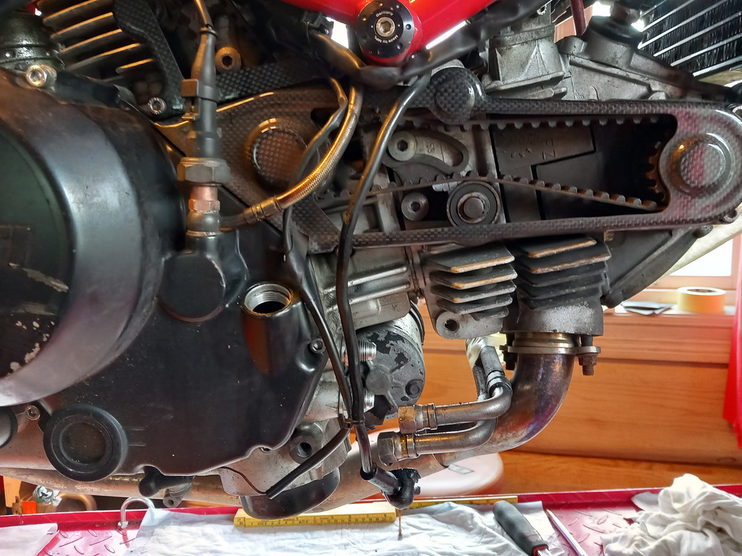

New injectors today
The air filter box usually puts up a fight - both off and on, but not today. The old injectors themselves took a little pulling to remove, but the new were easy to slide in with a little silicone spray. Even the make the beast with two backsing electrical connectors went off easily - no springs flying off.

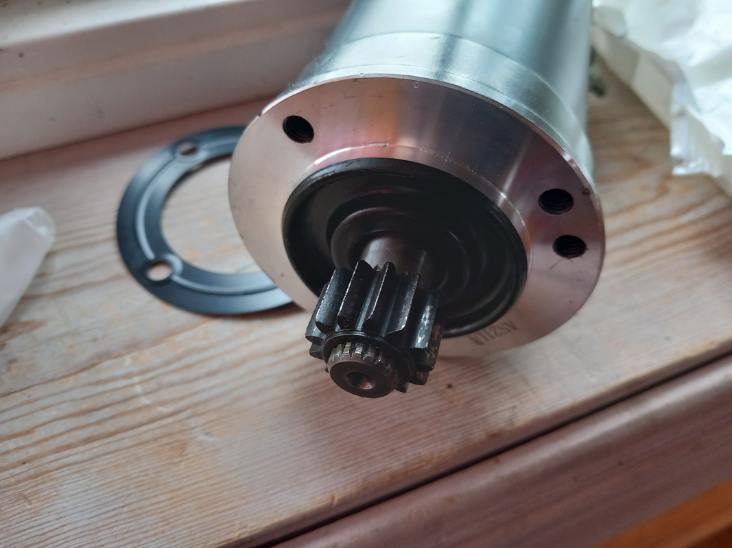

Anyone have experience replacing the starter? Is the gasket usually toast or can it be used again? The workshop manual says "inspect for wear and replace if necessary".

Chances are the gasket would be good. To me "chances" means you need it to finish the job. Ducati Omaha says one pack (two gaskets) is $7.98. What would cost you with shipping andtaxes? No idea. I could by them and mail them to you if neccessary. I think it woukd also be easy enough to make.

If it's the old style gasket it can be helped with three bond/sealant after cleaning on the exposed side. Thats if it is stuck to the case and not the starter. Removing from the starter may ruin it. The new gaskets are metallic to stop them insulating the earth through the starter body! No wonder we put extra earth cables on them! Any three bond/sealant makes it worse. So using a paper gasket may mean adding another earth cable to the bolt that goes through the cases and into the starter motor body. So greasing and locktighting that bolt doesn't help the earth point. If you cant retrofit the metallic gasget, try a cable from the frame battery earth point to the timing case bolt that holds the starter.

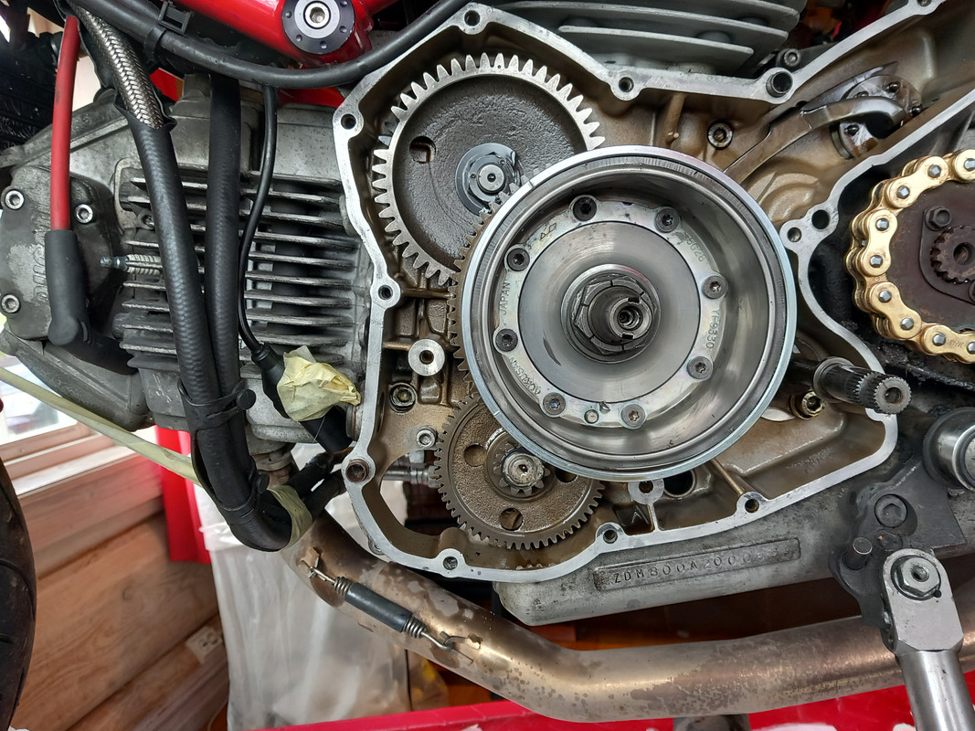

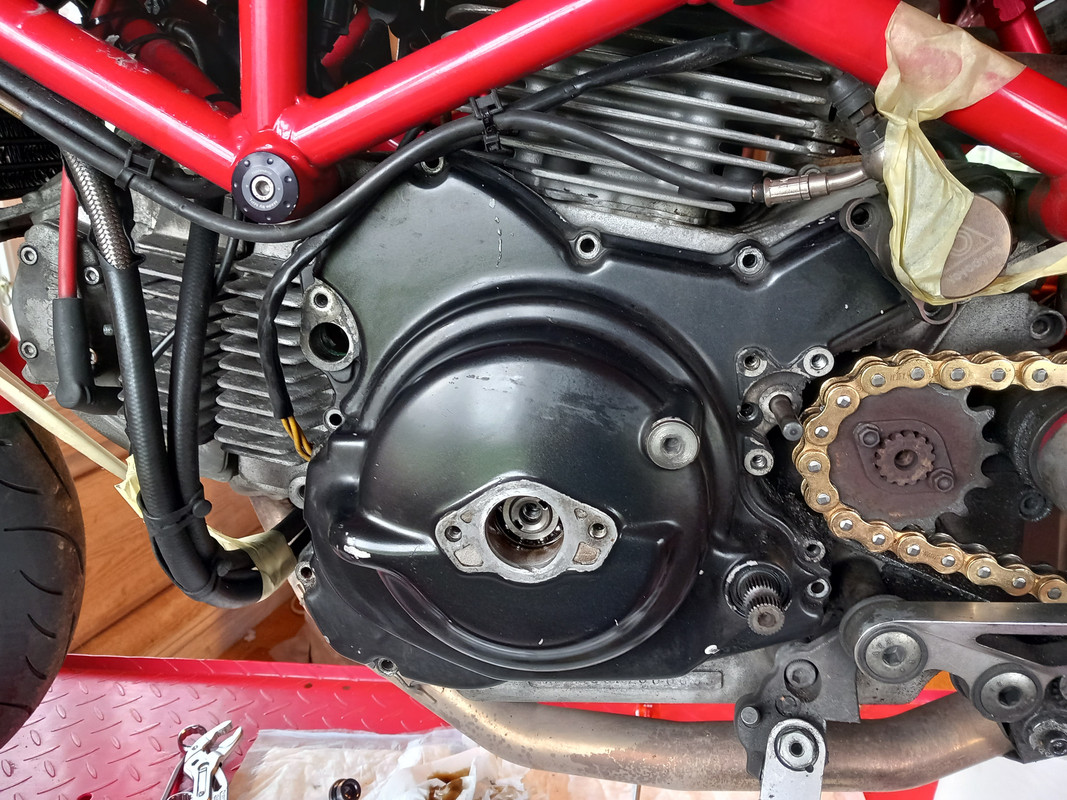

Just a short question first; is it normal that the gear selector output shaft is a little loose? I thought I saw it wiggle a little when I put the side cover back on.
Other than that, I'm really pleased that it went well AND that it started so eagerly. One casing hole threads stripped. I hope the neighbouring bolts will do the job. Rain today so I haven't tested if the cover is oil tight.
BTW there was no gasket between casing and starter. Just some liquid gasket residue.
Clearing the way
Soon....
Avoiding short circuits
New stuff (aftermarket $160 vs 450 OEM)
Today's co-mechanic and moral support

Which brand starter? I've been told that the Arrowhead brand is often used by workshops here. I've only used one in an MTS as I usually have them rebuilt. I see the gasket in the pic, looks like the metallic one.
. The outer case supports the gear lever shaft. How much play with case fitted?
Cute dog.

https://www.carpimoto.it/en-NO/Bike_Ducati_Monster-S2R-800/36803_27040011A-Engine-Starter-for-Ducati-engines-listed.htm
No play with the cover fitted.
