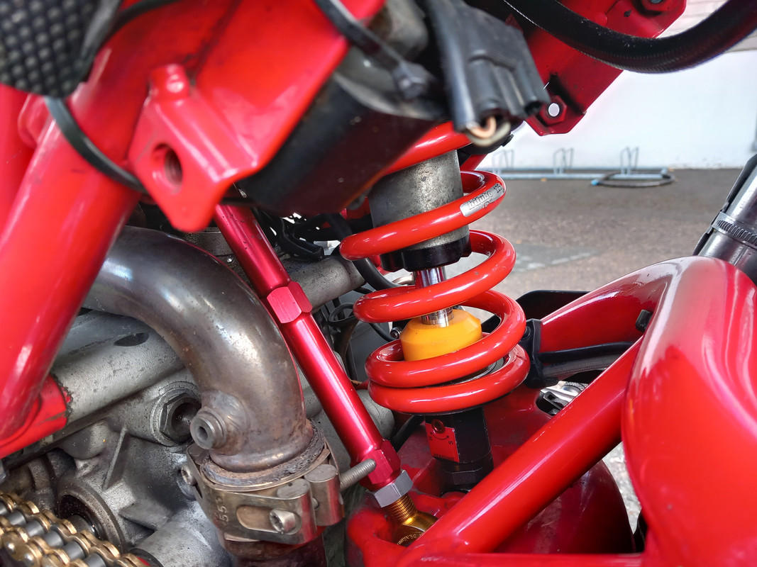

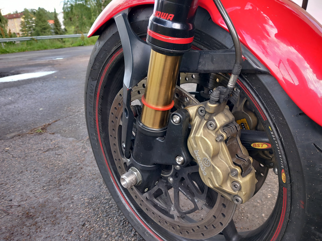

The fork is now smooth as silk - new oil and improved shim stack. Shock normal service plus seal head repair kit and a new rebound adjuster screw. Both items have performed well ~70-90,000 km.
The height adjuster rod was a bit sloppy, so I ordered the US made rod from MotoWheels. Available in red anodized only (horrible color on a red bike). Nice and tight.

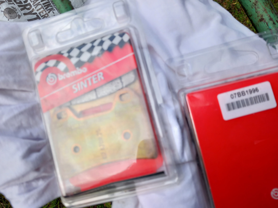

Meaty new pads. My preferred hot sinter Brembo - poor performance when cold and/or wet, but fantastic when hot.
