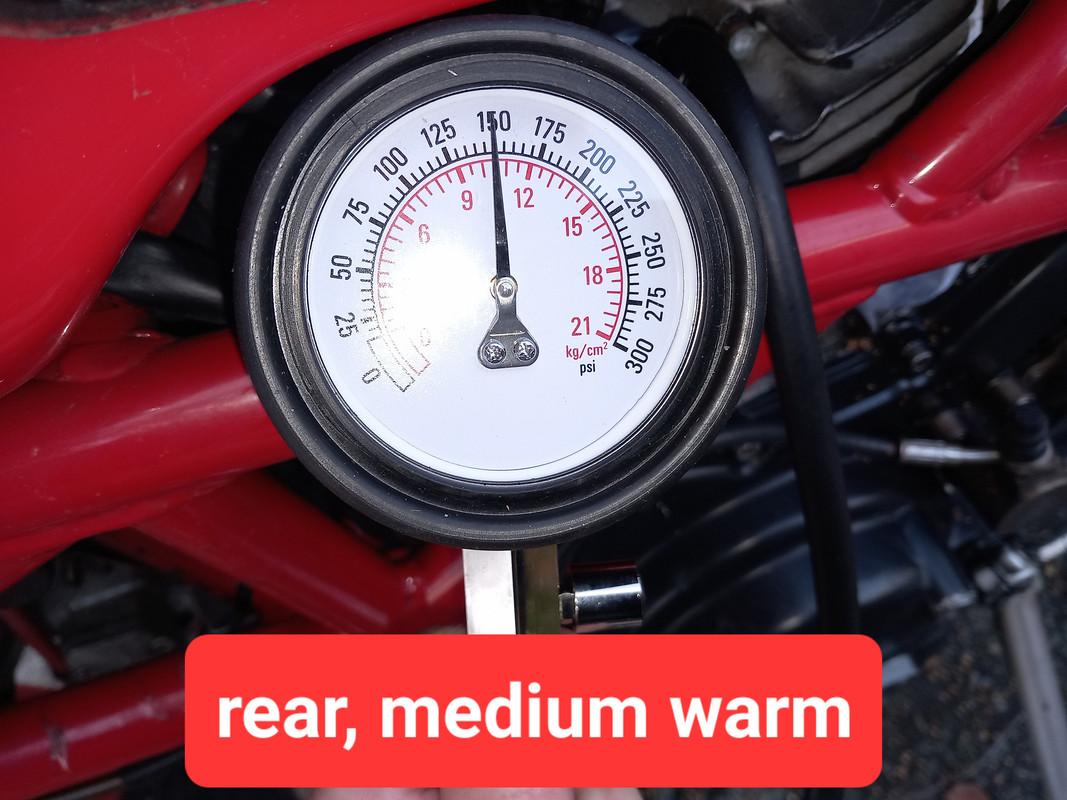

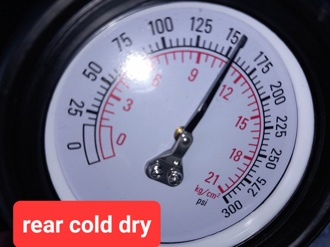

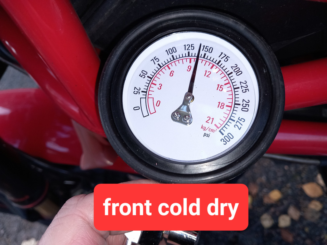

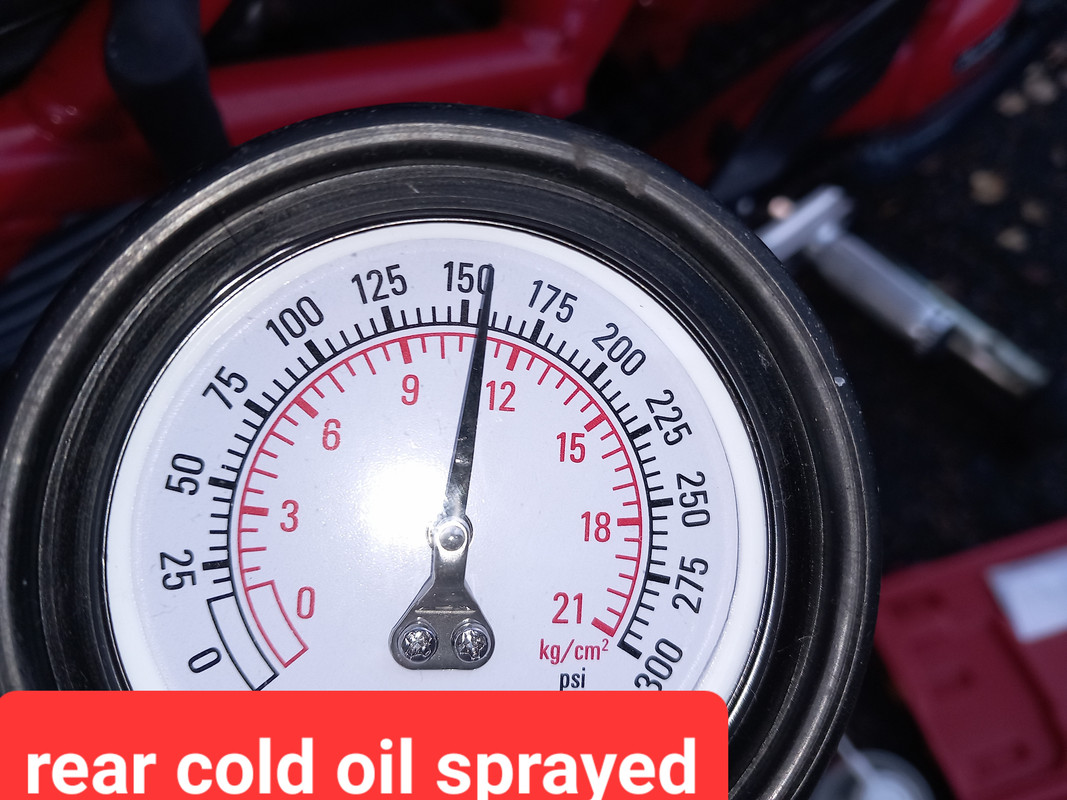

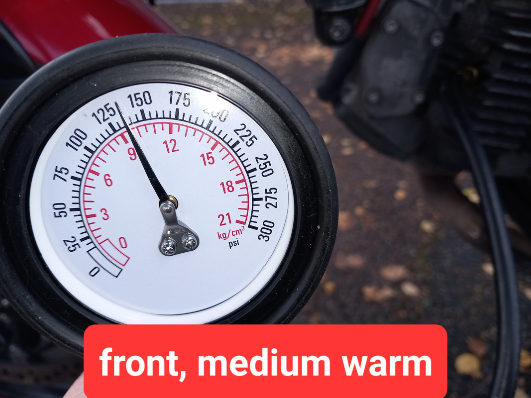

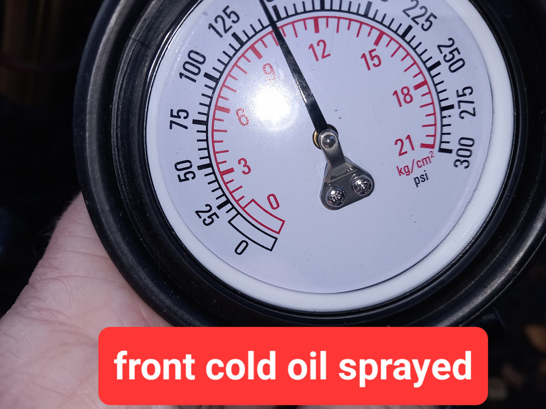

Compression test:
When we had to accept that the TPS and ECU faults were not the only issues we have to go back/sideways into the mechanical stuff again. I think it might be a specific mix of eletronic and mechanical issues that, in certain rev/load areas, make a mess of things. The engine guy needs more info and wants a compression test.
Remember also that this engine was drowned last fall, while I was hospitalized, with rain/snow filling my air box, into the intake and ended up in the oil. It's not impossible that it did harm to parts. I still run old Pistal pistons (yes, I will repalce them next year).
