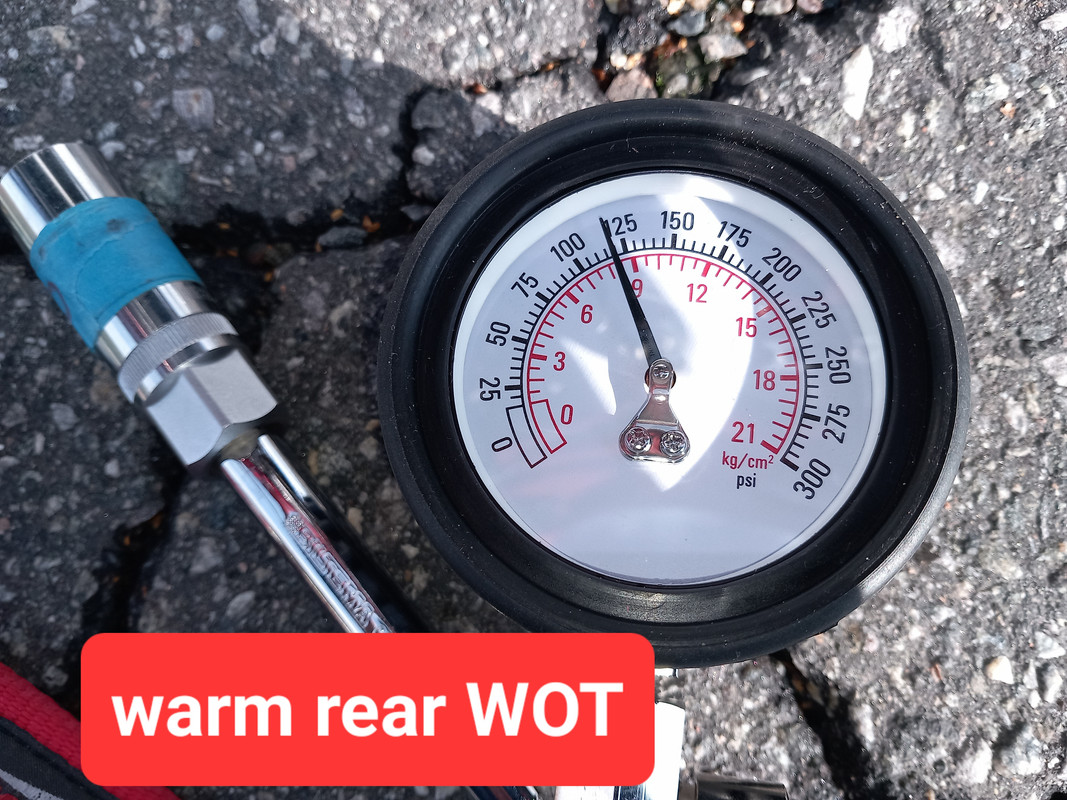

Ok - new test, proper warm engine and WOT.
(I tried with the rubber cone and besides an attempt to spit it out, it was ok. Would like to have had three hands, but ok)
Same result on both. Lower.
Biggelaar is happy to more or less rule out big mechanical problems. Switch coils is next. One exhaust was cold when I let it run on one cylinder. If the other is cold after a switch, we just might be closer.
The coil switch didn't make any difference. Rear cylinder, measured infrared on the exhaust pipes, is half the heat of the front. This is at 2-2,500 revs, idle lever pulled, which sounds like it makes the bike go on one and a half cylinder.
I feel a little lost, but will soon enough move down the list.
