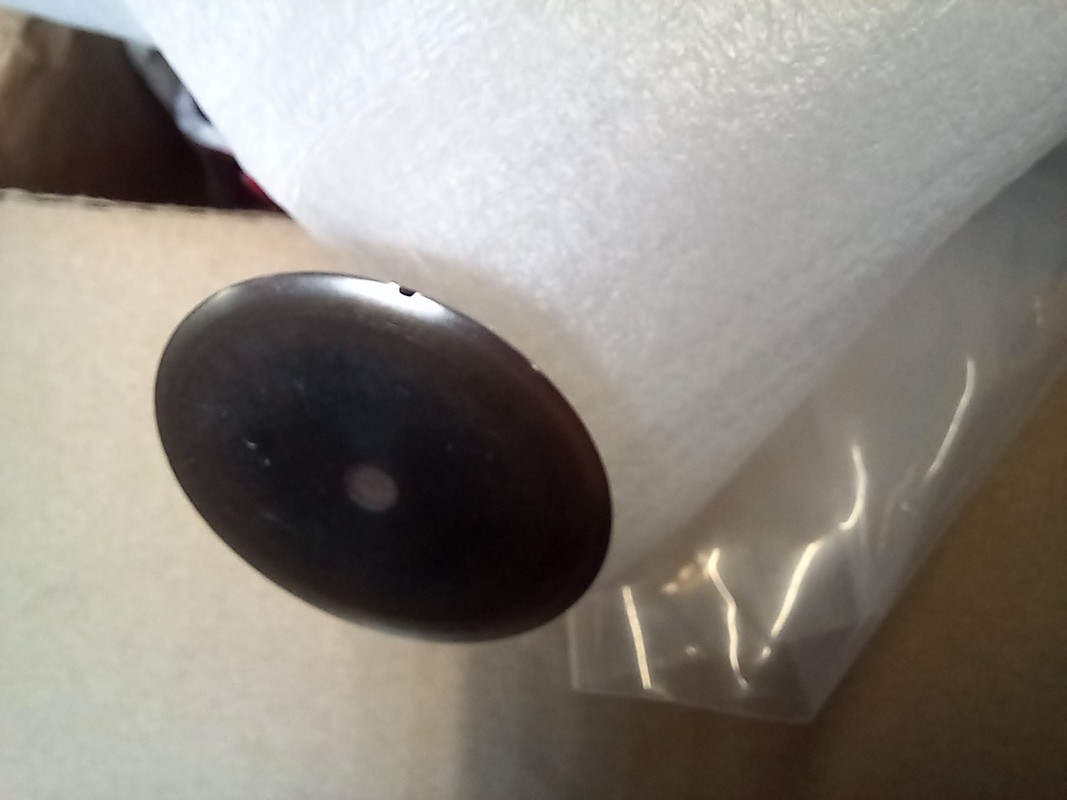

Heads cleaned. No damage. Valve seats lap'ed. Guides good.
Two tiny chips on one valve. Replaced.

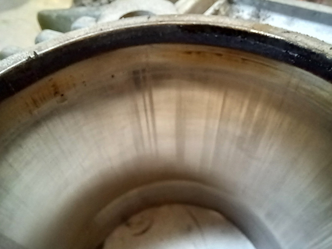

Minor signs of up-down stripe wear. Will be replaced by criss-cross with the ball brush

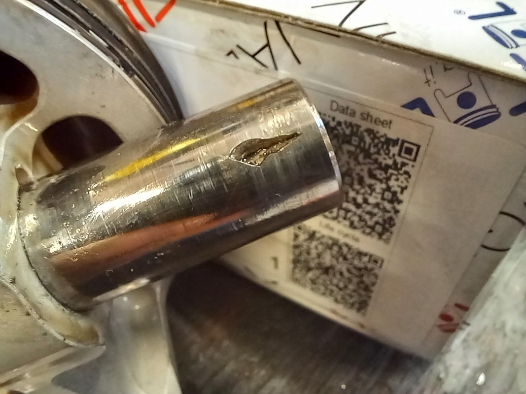

Deep damage on one piston pin. Maybe to be expected after 240,000km. SOMETHING has to give?

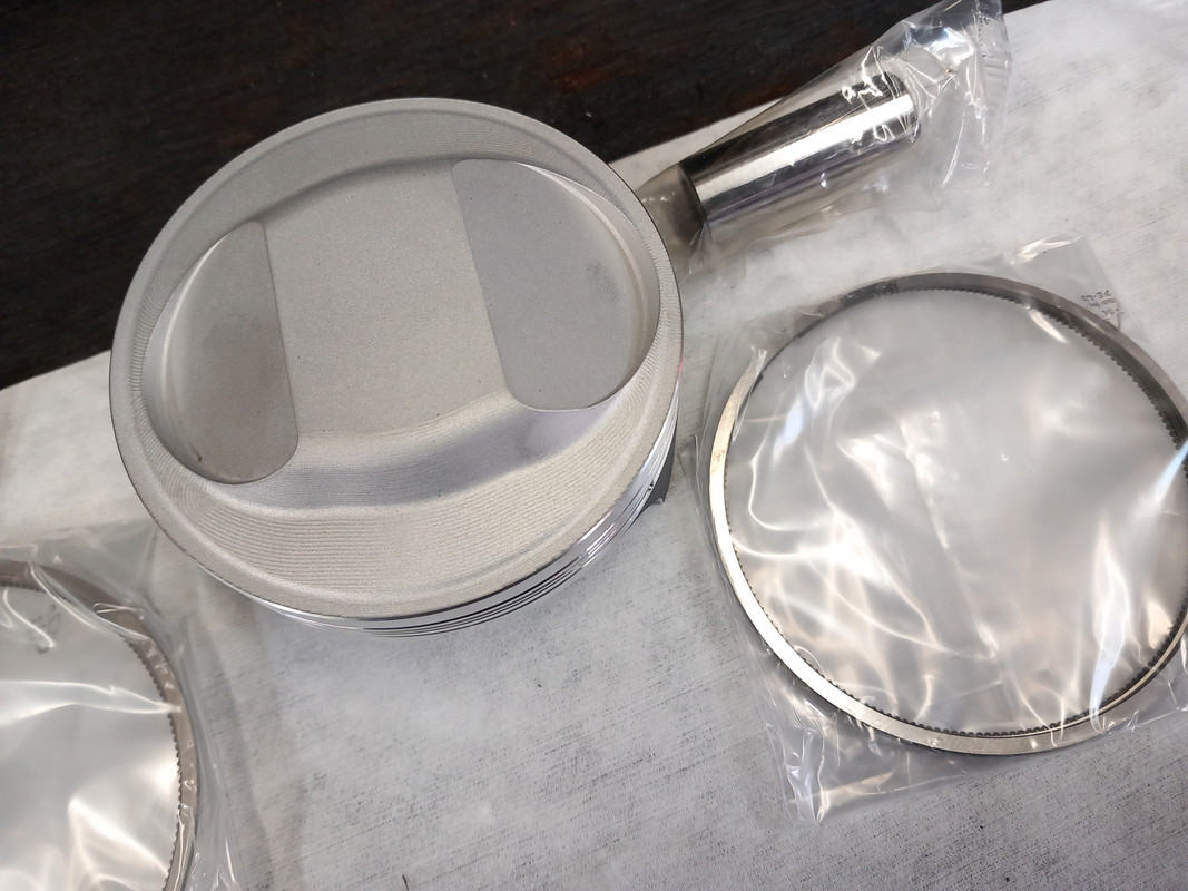

New pistons in 8)

What compression ratio pistons.?
Don't know. Probably won't know. These are labelled "796 big bore 90mm". Their dome is lower and might give a softer combustion (so they say). Have been 11:1 so maybe the same...
