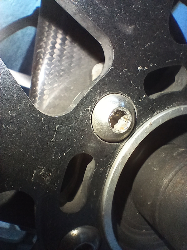

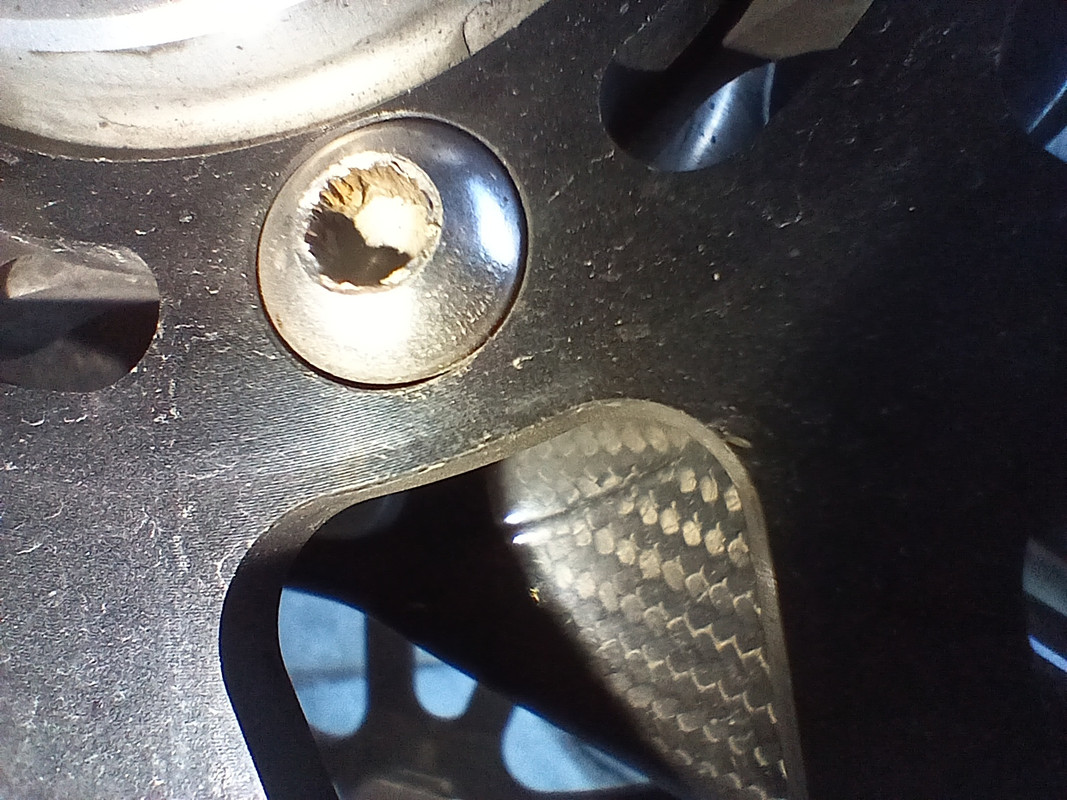

I wasn't told by the mechanic who put these discs on that the bolts were completely gone. Surprise! Not impressed. I have a set of cheap extractor bits. Wish me luck😎
