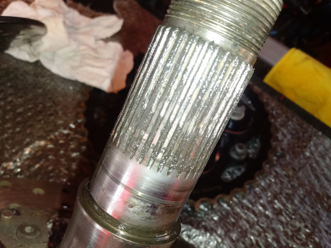

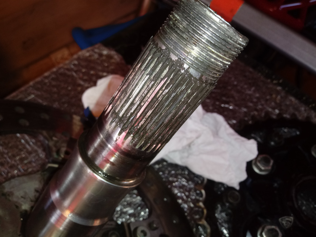

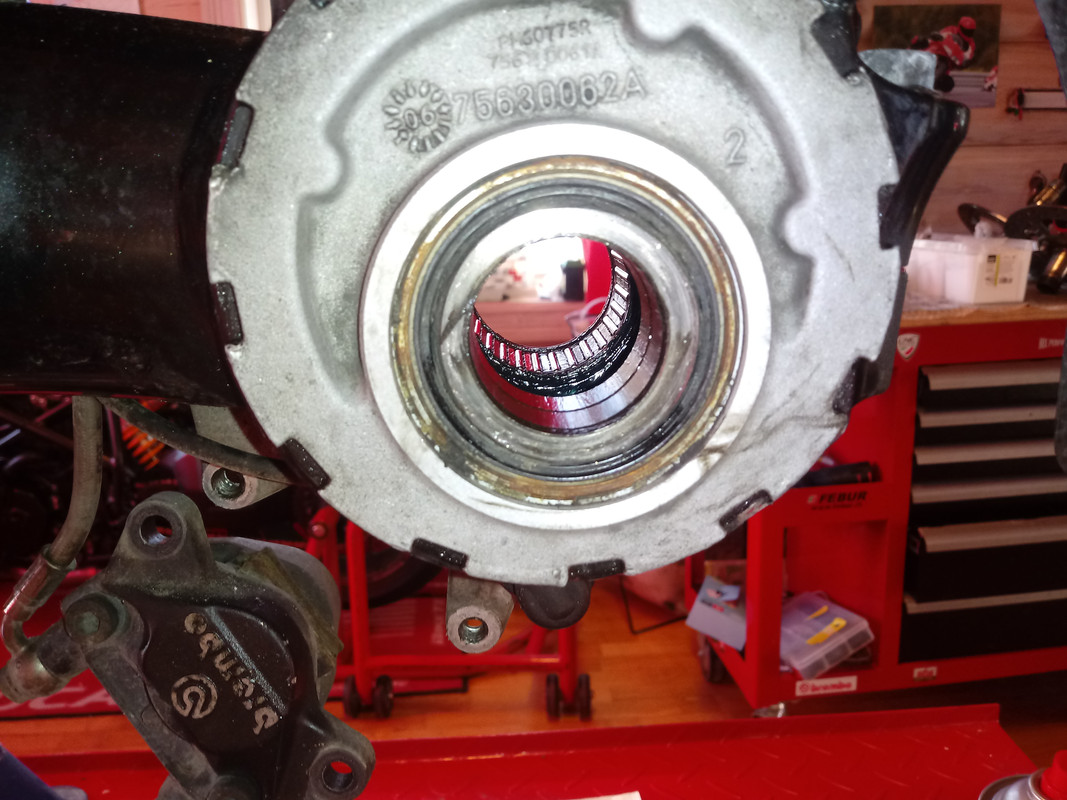

Axle splines gradually worse. It was time. I bought a used swingarm a few years ago and the seller let me have the hub too. So today I started with the axle. Once the bike was up it was easy enough.
Wheel off. Fairly new quick change sprocket flange off. Conical spacer. One large spring clip. Washer. Brake caliper. Careful knock. Grease here and there. Back together. I hopefully didn't damage the bearings.

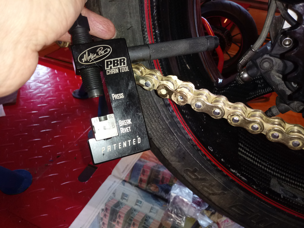

Chain replacement. I just recently started doing the chain myself. I could do without the fiddlyness.... I bought two extra master links and today I used both  [bang]  First I tightened JUST a hair too much. Next the plate was uneven and the link I didn't check was too tight. Third was careful enough.
^  (I think the washer location is wrong... probably not under the conical spacer, but under the axle nut)

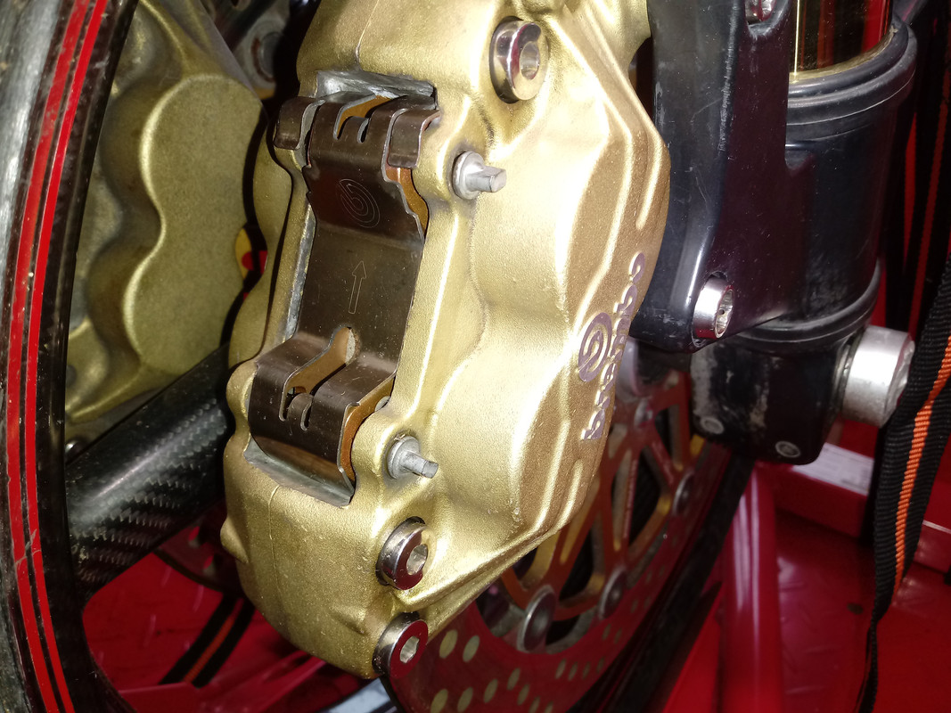

Caliper and brake piston wash. New sinter pads, one step above my previous. Always a good feeling to add stopping power.
