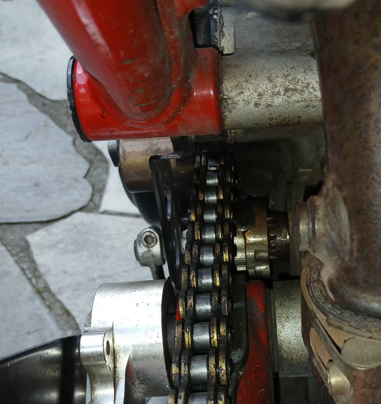

Italy on holiday, 40 degrees C. WTF why is my chain 15-20mm off allignment?
Because the splines on the output shaft are no longer sharp 90 degrees where the lousy retaining plate contacts them, to stop the sprocket from floating inward. Rounded splines makes even a new plate get hammered and slide inward.

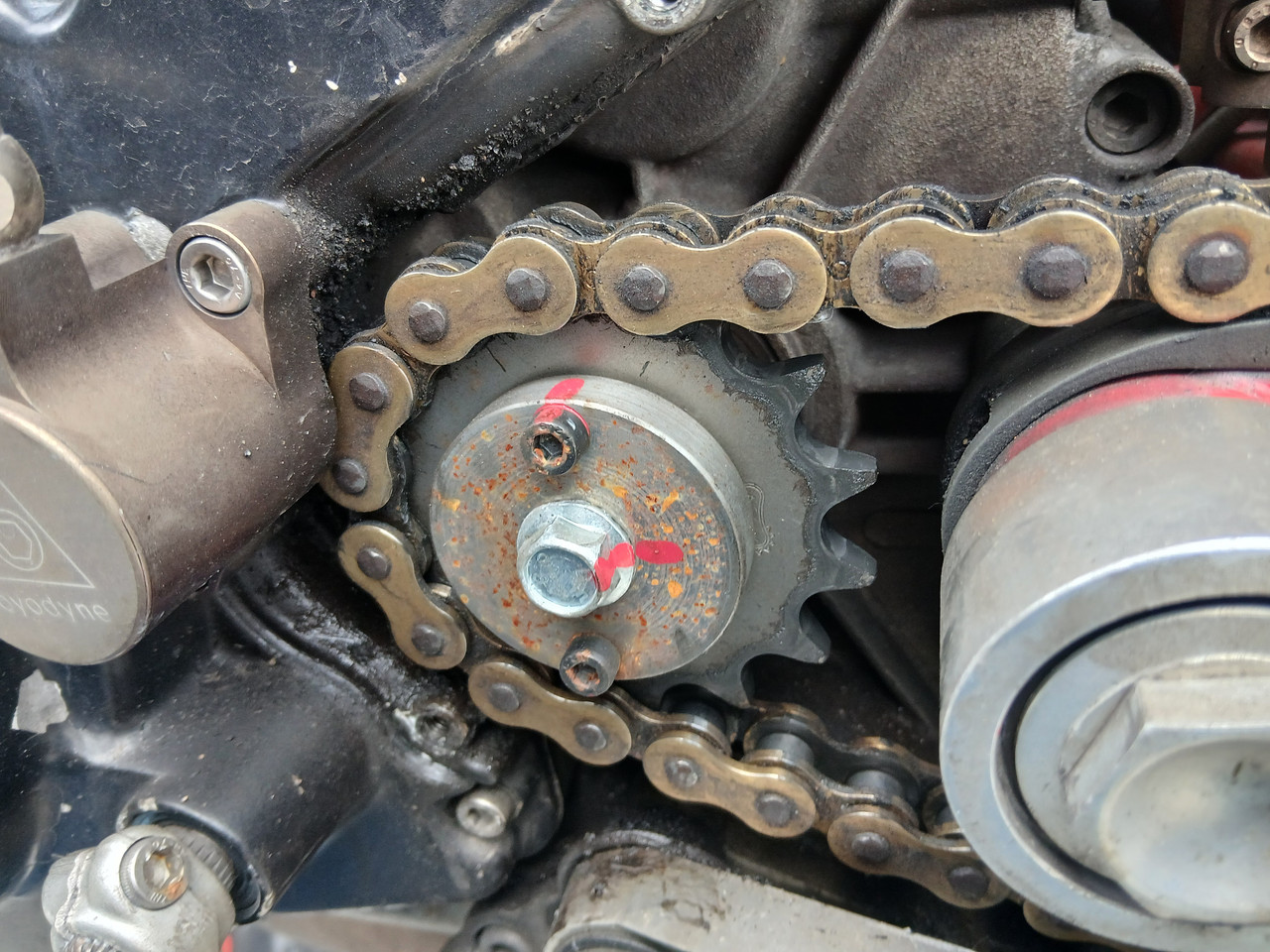

Ok - managed to get one of the Ducati Bologna mechanics to help. Imagineering was the name our Desmo Devil inventor (Mark?) called it. Plus maybe some internet inspiration.
It's a new sprocket + part of the old = good wide shaft contact. Then a "cup" instead of the plate. The cup holds the sprocket and secures it from sliding by bolting it to the shaft (there's a threaded hole in it).
Italian KK Bike has made something similar for years. Maybe not as sturdy...
