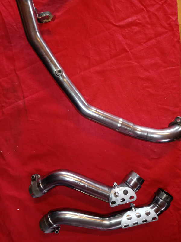

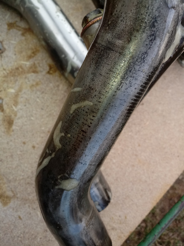

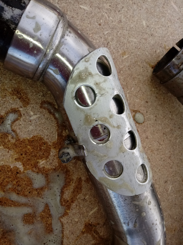

I found a couple of OLD threads on the subject and one of them used WD40 and Scotch Bright pads, however, the images in the thread were no longer showing. That is the method I went with since I had those things handy. Acid sounds scary and I don't want to get involved in black market toilet bowl cleaner!  [laugh]
I'll roll with this for now. I am really quite surprised how much they cleaned up.
Mark
