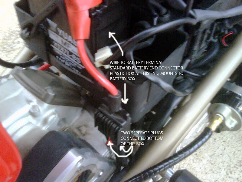

No problem, yeah you reall need to replace all 3 to get the full effect.  I can snap some better pics for you but really what you are talking about is this:
The factory positive splits into 2 seperate leads, one goes back to the fuse panel under the seat and you need to leave that one as is.  Follow the other lead from the postive, it goes under the battery to your starter soleniod.  (the little black box with 2 wires coming out of it).  You need to pull back the boots and remove the nuts on both wires with a socket.  You will be removing the factory wire that split off from the positive and went to the solenoid. (Throw it in a box or something, you no longer need it.)  The other wire that comes out of the starter solenoid runs down to your starter under your motor.  That wire needs to be replaced also with the new better thicker one.

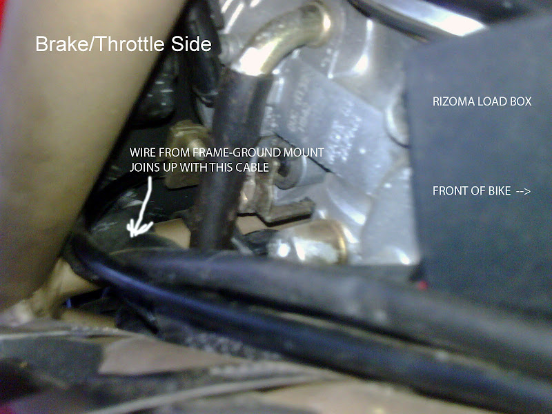

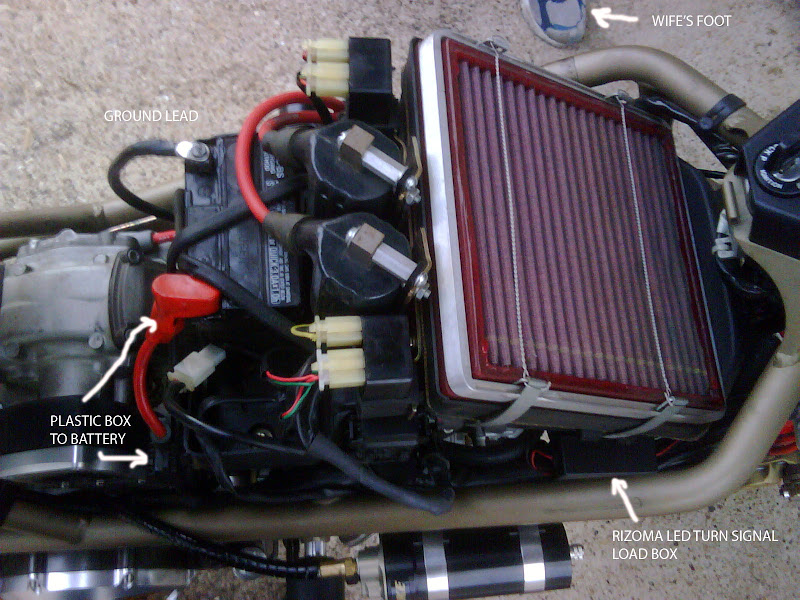

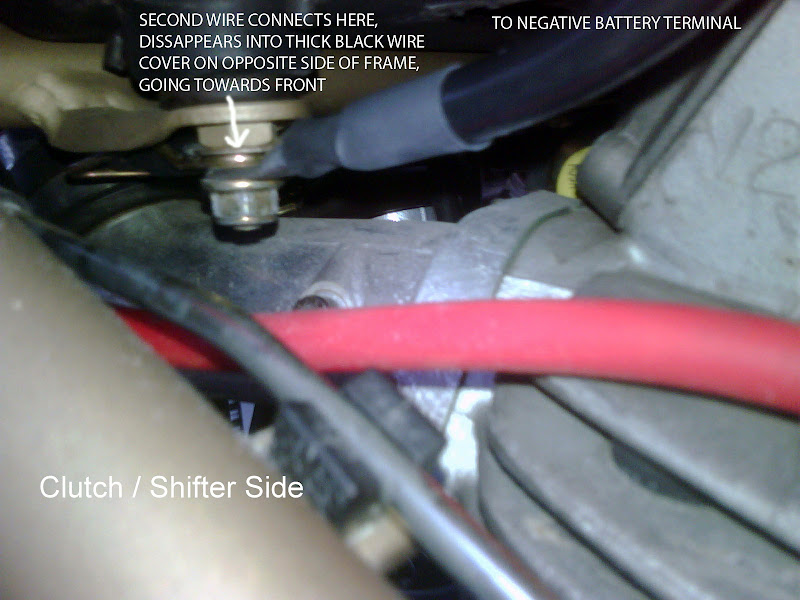

how do you replace the lead that goes down to the plastic splitter? Here's my pictures and confusion. I even have included..."Notes" on the pics.
Let it be know that I really am not sure what I'm doing, and while I see something lurking below the battery box with what looks similar to spark plug leads going into it (starter?) I dunno which is the solenoid and which is the starter. If somebody could kindly indicate which is what or where I should be looking, I would have that "oooooooh" moment and maybe make some headway.
Stangman
The solenoid is the device this cable was plugged into, the starter you really cant see much of its at THE VERY BOTTOM of your engine if you follow the other cable out of the solenoid.

Ok, so it seems that I will be connecting two wires to the battery's positive terminal --> Got an email back from Powerlet:
Here be the text:
QuoteFirst, I want to confirm that you received the WKT-004.  Second, according to your pictures, it looks pretty standard to me.    You should disconnect the lead going in to that Plastic Box from the starter solenoid.  You will then run the appropriate lead from the solenoid direct to the battery in addition to the existing Positive lead.  The remaining (long) lead will go from the solenoid to the starter.  If this does not work for you, please give us a call at the Toll free number below so that we can get you taken care of.
