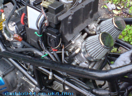

I know its also possible to just cut up the airbox, like this:
I've also seen these:

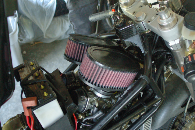

(with Mikunis)
I'm not sure what this guy did for his battery or coils, but I ran across this searching, too:

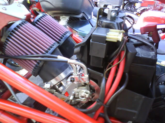

this is my doings. i came up with a new battery box but wasn't 100% happy with it. trying to come up with something that's nice and clean. i came across this set-up on another site that really caught my eye.
about half way down on the 2nd page.
