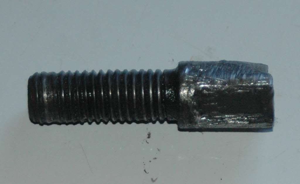

Finesse is going to be be necessary with bolt #2.  I moved it 1/16 of a turn maybe.  I sprayed it with PB and quit for the night.  I'll remember the slow working + tapping.  I did get the rear-most of the two bolts free and out.  It's nicely galled.  Pics later.

Progress!  Well done!  Yeah, now that it's moving more lube, more patience.  It has some space to seep in there now.  How do the threads in the case look on the on that came out?
Scott
Haven't looked at the case yet, but the threads on the bolt were still there but showing come galling.  I'm sure a little cleanup on the threads might be in order.  I'll post a pic of the bolt tomorrow ~

Ok, Here's the pic of the one I got out.  Threads in the case look in, there's a little debris in there, but it's dry and loose so some air will take it out.
The bolt:
Now, for the bad news.  Heat, penetrating oil, tapping etc did not move the bolt.  I'm marking a drill bit so I don't go too deep and drilling out the center of the bolt.  The bolt snapped off about 3mm inside the case, so there's nothing left to grab.
